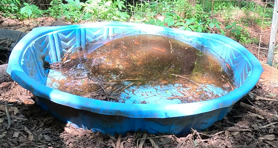

The first and easiest addition is a kiddie pool. You legitimately just drop it in the chicken run and it helps with the cause by being a big ol' tub for rainwater to accumulate in. Plus, if you're considering adding ducks to your flock, you need a kiddie pool for them anyway. Not only do ducks love splashing around in water, they legitimately need it to stay healthy. They rely on swimming in water to keep their feathers clean, as well as their eyes and nostrils. So it is definitely necessary if you have ducks to have a source of fresh water at all times, and this is the easiest way to provide it. It's also worth noting that chickens eat mosquito larvae, which should mitigate any concerns you might have about adding standing water to your yard. Instead of creating pests, you're just creating a bit more food for the chickens!

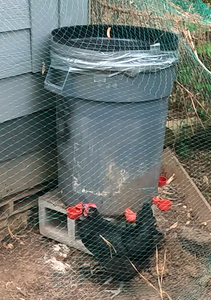

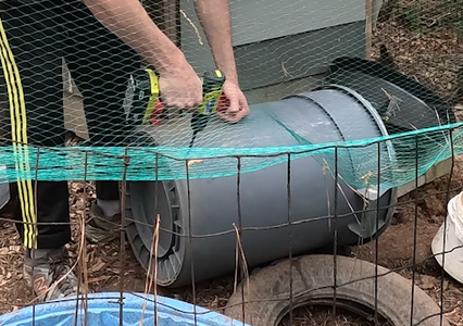

The more in-depth and effective solution involves repurposing an old trash can. You can buy chicken water cups for cheap online, and then you just drill a hole toward the bottom (as shown above) and screw the water cups in place. You'll need a 3/8" or 1/2" drill bit, depending on the cups you purchased. The ones linked in the supplies list require a 3/8" drill bit. They come with little twist-on pieces, so you can just shove the cups into the hole and tighten the twist-on piece until it's fully locked in place. These refill without overflowing, so the water that accumulates in the trash can keeps these little cups topped off. Chickens, as dumb as they might be, have no problem finding food and water and ours near-instantly figured out how to use the cups for water.
This brings us to how to fill and keep this trash can full of water. Trash can lids are often domed, and some even have a hole in the top middle already. If not, you can drill a hole in the middle of the lid. Then simply flip the lid upside down and secure it to the trash can to create a simple makeshift funnel.

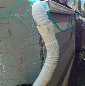

Now for the important part - actually keeping the trash can full. It's becoming more prevalent to do rainwater collection from houses, and this is done by connecting a pipe into the gutters and filling a rain barrel from the runoff. We're going to do basically the same thing with our trash can. By adding sloped gutters to the chicken coop roof, we can very easily guide the water to our trash can and fill it with rainwater. Where we live it rains a lot, so even just with a small stretch of gutters we have had a consistent source of water for the chickens. Worst comes to worse, and it hasn't rained in weeks, just pull out the hose and fill er up every now and then.
One consideration is for when the chickens are stuck indoors for one reason or another. Whether that's weather, a dead battery in the automatic door, or whatever else, it makes sense to have a smaller water source indoors that can also get refilled. A likely addition that I'll install at some point is to add a small additional segment of water collection tubing outside the coop with a small pipe through the wall that can funnel water inside the coop into a gravity fed waterer. This way, there's yet another source of water in general, and possibly a huge help on a (maybe literally) rainy day.

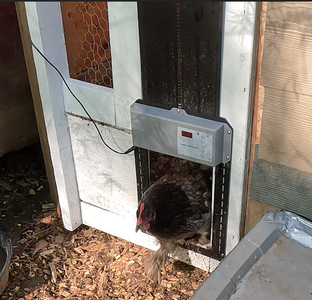

This step will be pretty quick, since the goal is to utilize a resource that already exists. Chicken doors are available online for purchase, and many include solar power as well as normal battery or electric power hookups. I'm a big fan of solar power in general, since it's a green solution with a 1 and done cost that then provides power for itself from then on. If you have a lot of sunlight in your chicken run, or at least a convenient power source, you will likely be all set with the currently available options.
Chicken doors are pretty easy to install but have a few things to consider. Particularly with solar powered doors, you'll likely have an electronics box, battery backup, and the solar panel itself to place. I did end up installing ours within the door to the chicken coop, since I needed to build a new one anyway, so I attached the battery pack to the back of the door and created a small shelf off to the side for the electronics box. The solar panels should be mounted wherever you have the most sun regardless, so it's worth noting that you don't necessarily need to even install the chicken door within the larger door you use. You could just as easily cut a hole in a wall and install it there, which could be more ideal in some setups.
As noted, I was already making a door, so I just left a chicken-door-sized hole in the door and screwed it in place. Otherwise, in most cases it would just be a matter of creating an appropriately sized hole with something like a Sawzall if it's wood, or wire cutters if you have a wire set up, and screwing the chicken door in place.
This is actually the one part of my own setup that I'll be revisiting, so I may reinvent the wheel a bit on this one and build custom chicken door electronics so as to better optimize the low-power needs of our setup. Our chicken run is heavily shaded and not near a power source, so I'll likely look to build a new low-power option in the future. Hopefully the existing solar options suit your needs, or you at least have a convenient power hookup.

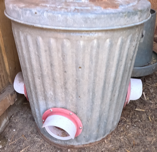

The initial intention I had was similar to that of the water feeder. I was going to repurpose an old trash can and set it up as a chicken feeder. We stumbled upon a larger feeder, so this became unnecessary. Even this though is worth a note - despite how many people are starting to get into raising chickens, there are still plenty of things being given away for chickens. We got this for free from someone that was moving, so it's certainly worth looking for. Regardless, here is how you can go about making a large feeder for yourself if needed -
  1. Drill holes toward the bottom of the trash can that fit the size of the PVC piping you have. A two to three inch width pipe is best for fitting chicken heads inside. It's also a good idea to have the holes positioned a few inches up from the base of the trash can so the feed doesn't spill out onto the ground.
  2. Cut your PVC pipe into sections long enough to reach from the holes in the trash can to just below the top of the can.
  3. Attach a PVC elbow to one end of each pipe section. This elbow will be on the inside of the trash can and will be what the feed falls into. The other end of the pipe will stick out of the hole you cut in the trash can. Make sure the PVC elbow is facing upwards, to allow feed to collect in it.
  4. Insert each pipe section through a hole in the trash can, so the elbow end is inside the can and the other end is outside.
  5. Secure the pipe to the trash can using a waterproof adhesive, silicone sealant, or PVC cement around the hole. Ensure the seal is watertight to prevent feed from leaking out.
  6. Allow everything to dry thoroughly before use.
Once it's dry, just fill the trash can with feed and you should be good to go. The feed will flow down into the PVC elbows inside the can, but not spill out thanks to the gravity-fed design. As chickens peck out feed from the exposed PVC pipe outside, more feed will flow down to replace it.

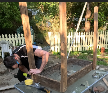

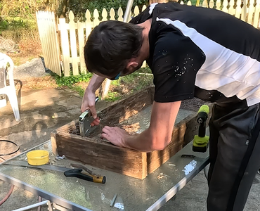

As for setting it up, it's a pretty simple structure. Find 4 pieces of wood you can use as the legs and wider pieces that can be used for the border of the dirt container. You just screw or nail the border together. Then, you use your staple gun and connect your wire mesh to what will be the bottom of the container. If the mesh isn't wide enough, you can use zip ties to connect the pieces of mesh together to help keep the dirt in.
Then just screw the legs of the container onto the border and you're done. I went straight for the worst wood I had available to me and it served its purpose well. A brief note is that I used different length legs because of the slope of the chicken run, so that may be something to keep in mind for yours as well.
Then you add dirt on top of the wire mesh. I also added some leaves and such as well so that this is somewhat like a floating compost bin, with plenty for the worms to eat as they go. As far as getting worms goes, it's crazy easy to get a ton of worms. There's no need to buy them.
