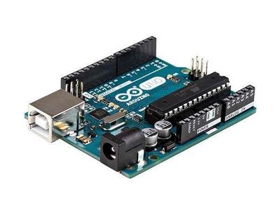

  1. Arduino UNO (Or any other Arduino)

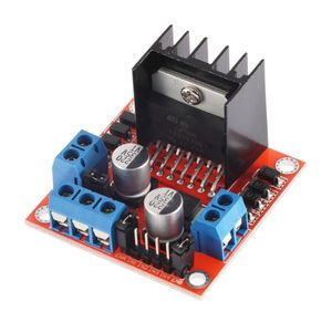

  3. LN298N DC Motor Driver

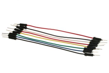

  4. Jumper wires

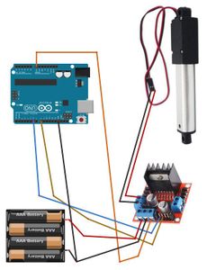

Step 2: The Circuit
  1. Connect Power supply (batteries) pin (gnd) to motor driver controler pin (gnd)
  2. Connect Power supply (batteries) pin (+) to motor driver controler pin (+)
  3. Connect Power supply (batteries) pin (+) to Arduino pin (VIN)
  4. Connect GND from Arduino to motor driver controler pin (gnd)
  5. Connect digital pin(6) from Arduino to motor driver pin (IN1)
  6. Connect digital pin(8) from Arduino to motor driver pin (IN2)
  7. Connect Linear Actuator to the motor driver as you can see on the schematic

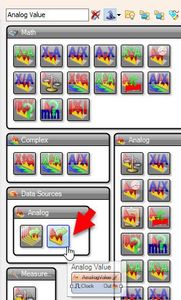

  2. Add "Analog Value" component

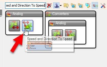

  5. Add "Speed and Direction To Speed" component
  6. Add "Dual DC Motor Driver Digital and PWM Pins Bridge (L9110S, L298N)" component

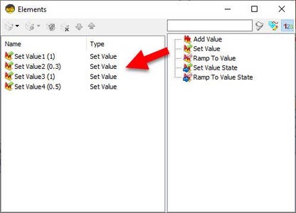

Double click on the "Sequence1" and in the Elements window drag to the left as many "Digital period" elements as you like, in this example we will add 4 "Digital period" elements and for each we will set the Delay in the properties window:
  1. Digital Period1: 1000
  2. Digital Period2: 6000
  3. Digital Period3: 10000
  4. Digital Period4: 15000
Double click on the "AnalogValue1" and in the Elements window drag to the left as many "Set Value" elements as you like, in this example we will add 4 "Set Value" elements and for each we will set the Value in the properties window:
  1. Set Value1: 1000
  2. Set Value2: 6000
  3. Set Value3: 10000
  4. Set Value4: 15000

  10. Connect "AnalogValue1" pin [Out] to "SpeedAndDirectionToSpeed1" pin [Speed]
  11. Connect "TFlipFlop1" pin [Out] to "SpeedAndDirectionToSpeed1" pin [Reverse]

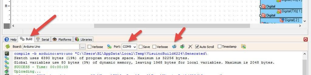

Step 7: Generate, Compile, and Upload the Arduino Code
In Visuino, at the bottom click on the "Build" Tab, make sure the correct port is selected, then click on the "Compile/Build and Upload" button.
