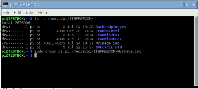

    Finally we finish off by taking a look at the backed up image file on the 1TBFREECOM HDD to check to see that user name and group are 'pi'.(see pic 7 above. User and Group are circled in red).
    • ls -l /media/pi/1TBFREECOM
    If not, then enter the following command (see pic 8);
    • sudo chown pi:pi /media/pi/1TBFREECOM/MyImage.img

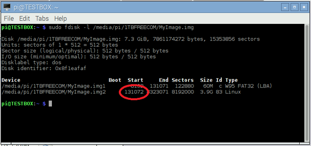

    Ok, we'll begin by getting the start point of the second partition on the uSD card. A Raspberry Pi image has two partitions, 1 Boot, 2 Where everything else is stored. To determine the start of the second partition enter the command below;
    • sudo fdisk -l /media/pi/1TBFREECOM/MyImage.img
    Take note of the 'Start' of the second partition '.img2', we'll need it later. Here : 131072 (see pic 1 above, red circle).

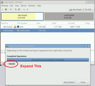

    Now we resize the partition with 'GParted'. From a terminal window enter the following command (see pic 3 above);
    • sudo gparted /dev/loop0
    This will launch the 'GParted' application (see pic 4 above).
    From GParted do the following;
    1. Select /dev/loop0 partition (pic 5 above),
    2. Select Partition menu -> Resize/Move (pic 6 above),
    3. Resize the partition by either dragging the slider left as indicated, or entering a value into the box marked 'New size (MiB)' (again as shown in pic 6). I found this to be a little trial and error and generally started with +500M and moved up in increments. ie Change the value of "New size (MiB)" to approx 500MB above "Minimum Size". In this case 2942 + 500MB = 3442MB etc.,
    4. Click 'Resize/Move' to finish,
    5. GParted will now indicate there is '1 operation pending' (as in pic 7 above),
    6. Click Edit menu -> Apply All Operations,
    7. Click 'Apply' to warning box (pic 8 above),
    8. GParted will now process the request to resize (see pic 9),
    9. If the resize is successful you will get a message: 'All operations successfully completed' (as in pic 10),
    10. Now expand the 'Applying pending operations' dialogue shown in pic 10 until you locate the line in pic 11, marked 'resize2fs -p /dev/loop0 ...' and take a note of the value. Here : '3506176K'. This is important, so, take your time to get it right.
    Note : If you get an error message at step 9 (as in pic 12), then click Ok, Close, and repeat from step 1 above, only this time add 500MB to your last resize. Repeat this until the size is accepted.
    It is now safe to exit GParted. Press Ctrl+Q (^Q), or menu GParted -> Quit.

      gorgonops
      gorgonops
      4 years ago
      Hi SteveQuinn,
      when gparted executes the job, it fails with the comment, that it needs root- or r/w-rights to work on the partition. How can I set this up?
