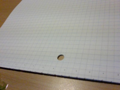

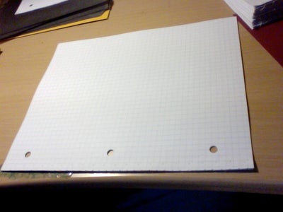

First you need to make a template. I like to do holes at 0.25 inches from the top and bottom of the book and every 0.5 inches in-between. I poke the holes 0.25 inches from the spine. The more holes you poke, the longer this is going to take, and the stronger your book will be.
This is the most frustrating and painful step. Got a thimble? Get it out. It is best to do this one group of pages at a time as it helps the pages stay together when you sew them.

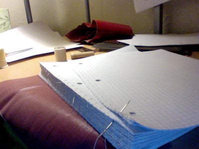

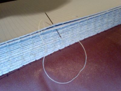

Whip stitching is a simple, quick way to sew anything together. Basically, in whip stitching you are going to thread from bottom to top of each hole. In bookbinding, you are going to use this stitch to attach signatures together one at a time.
First, tie a knot in your thread and whip stitch the first signature together. At the last hole, add the second signature, and whip stitch both signatures at the same time. If you go left to right on the first signature, when you add the second signature you will be sewing right to left. This is what causes the pages to be offset from each other, as each stitch pulls the signatures right or left. Sew two signatures together each time through: for instance, signatures 1 and 2 will be sewn together, then 2 and 3, then 3 and 4, etc.
Edit: Sew them loose! After you sew 2 and 3 together, you will need enough room between 2 and 3 to sew 3 and 4 together. I sew everything very loose, then tighten everything after I am finished with those signatures (for instance, you can tighten the sewing between 1 and 2 once you have started sewing 3 and 4).
After you add the last signature, tie it off, and give your fingers a rest.

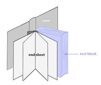

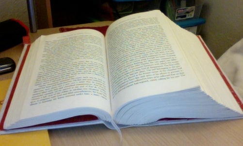

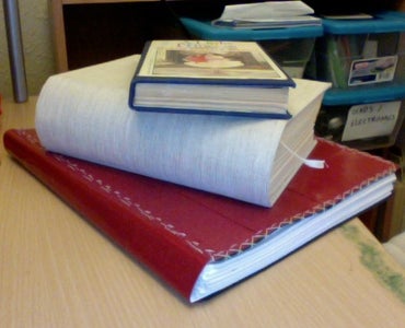

If you decide to do a traditional hard cover binding, you need to reinforce the spine after sewing. For the Count of Monte Cristo I glued cheese cloth to the back with PVA, rounding the spine as it glued. I glued decorative papers to the front and back, and used these to attach the cover (this method has a soft spine).

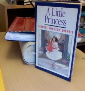

For A Little Princess, I reinforced the spine like the Count of Monte Cristo, but added a strip of binders board to make a hard spine. I glued the original front and back covers onto the finished product. Note: the hard spine made this book harder to open. I don't recommend it.

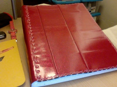

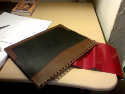

For the notebook, I added a hinge to the text block as I sewed. This was as simple as adding a saddle stitch to attach the cloth after whip stitching the first and last signatures. I sewed additional material to this hinge and sewed the material to plastic covers scavenged from a different notebook. This is a non-adhesive binding, which I vastly prefer over using glue.
Done and done! Add a pretty cover and enjoy your shiny new hardback book.
