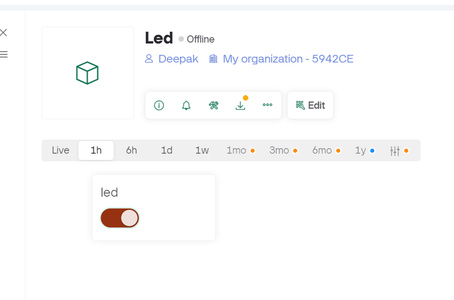

Step 2: Blynk App
Step 3: Get Your Auth Token
Step 4: Add a Button Widget
Tap on the '+' button to add a widget.
Select the 'Button' widget.
Tap on the button to configure it.
Set the output pin to the pin corresponding to the onboard LED of the Bharat Pi board.

Test Your Setup
  1. Control the Onboard LED:
  • Tap the button in the Blynk app to turn the onboard LED of the Bharat Pi on and off.
  • If everything is set up correctly, the onboard LED should blink when you press the button.
