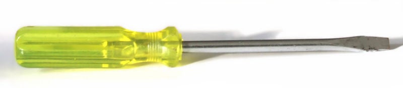

Once you get your parts, make sure you also have:
~ Phillip's or flat head screw driver (The size of the screws on the outside of the case)
--This depends on the type of screws in your computer case
~Small head Phillip's/Flat head screw drivers
--For mounting the motherboard/hard drive/DVD rom/CD rom/Floppy drive
