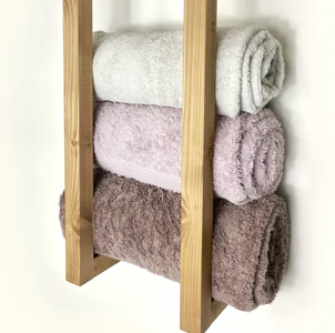

I often end up with lots of extra wood lying around, so I like to use it for practical projects whenever I can.
While sprucing up my parents' bathroom, I had some leftover 2x2 pieces that I decided to turn into a towel rack.
As we were putting the final touches on the makeover, I noticed that the walls, painted a bright white, felt a bit cold. To add some warmth, I whipped up a simple towel rack to hang over the tub.
In this quick three-step guide, I'll show you how I did it. Ready to roll up your sleeves and get started?

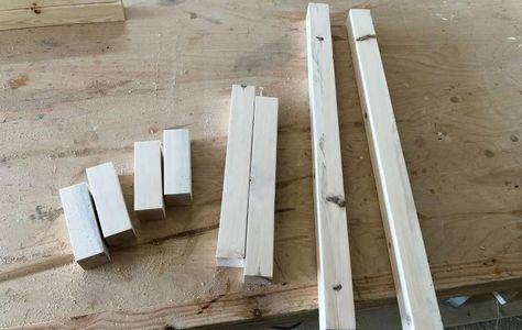

  • 2×2 scraps: (2) 2×2 @ 12″ long, (4) 2×2 @ 5″ long, (2) 2×2 @ 24″ long

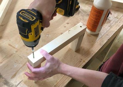

Step 1: Assemble Back and Sides of Towel Rack.

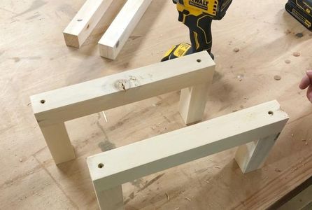

I cut two pieces to 12 inches for the back of the towel rack, and four 2x2 pieces to 5 inches for the sides. I also cut two 24-inch pieces, but they won't be used in this step.
Roll up one of your towels and measure its width to decide what would work best.

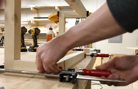

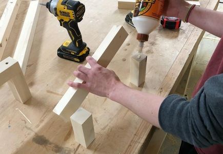

I applied wood glue to the ends of two of the 5-inch pieces and placed a 12-inch piece on them. Then, I predrilled and drove 2 ½-inch wood screws through the 12-inch piece to assemble two pairs of back/side units, as shown.
The screw holes in these assemblies will be along the back of the towel rack (against the wall).

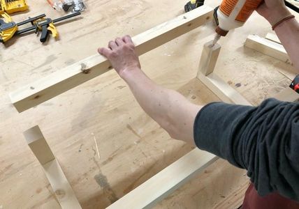

Step 2: Attach Front Pieces of Towel Rack.

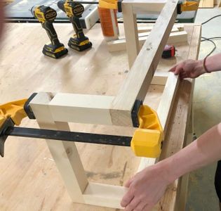

I applied glue to the opposite side of the 5-inch wooden pieces and secured the 24-inch pieces onto the front, as demonstrated.
You have options for fastening: you can drive 2 ½-inch wood screws as in the first step if you're okay with visible screw heads. Alternatively, you can use 2-inch or longer brad nails for added strength.
Ensure the piece is square before letting the glue dry.

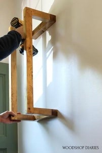

Step 3: Finish and Hang Scrap Wood Towel Rack.
Once the glue had dried, I removed any excess glue and applied Minwax Early American Wood Stain followed by a couple of coats of Minwax Polycrylic for sealing. You can choose your preferred finishing method.
For installation, I located a stud in the wall using a stud finder and predrilled through the back 2x2, then secured it to the stud using 3-inch wood screws—one at the top and one at the bottom.
Ideally, I aimed to center the towel rack above the bathtub, but since there was no stud in that location, I positioned the screw at the edge of the rack to ensure it could still be anchored into a stud while being somewhat centered. If you're unable to find a stud where you intend to mount the towel rack, you can use a drywall anchor instead.
And that's all there is to it! Just three simple steps, but it serves its purpose and adds a nice touch to the space.
