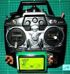

Introduction: How to Build DIY Arduino Transmitter OpenTx Firmware
Instruction "How to build DIY Arduino Transmitter OpenTx firmware" will describe how to build 2.4G 8-channel DIY transmitter using MEGA2560 Arduino controller installing OpenTx firmware which similar to commercial transmitter in the market.
The Arduino MEGA2560 will produce traditional PPM signal to send to RF module that can communicate to general transmitter modules like Frsky,Flysky,Orange,..etc.

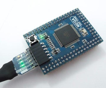

1. 1 - Arduino controller - MEGA2560 Core

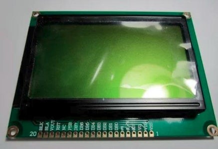

2. 1 - 128x64 LCD display 12864ZW with ST7920 controller

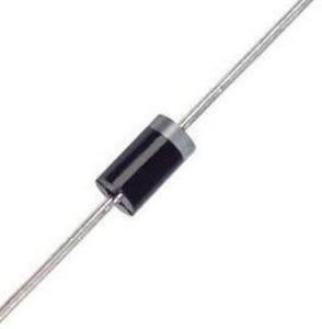

7. Diode 1N4007

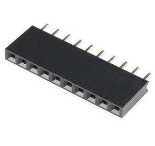

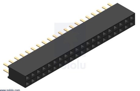

9. Female pin header
10. Double rows female pin header

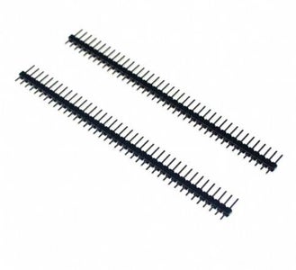

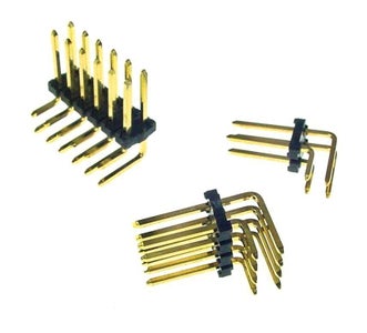

11.Single row male pin header
12.Single row long male pin header
13. Double rows male pin header

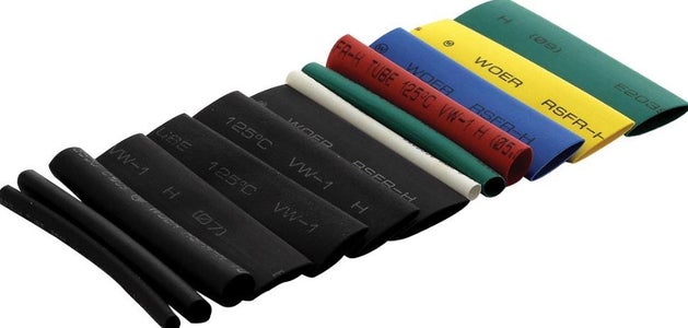

18. Heat shrink tube 1.5 - 10 mm.

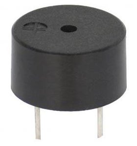

23. 1 - Piezo speaker

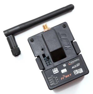

24. 1 - Transmitter module.(PPM)

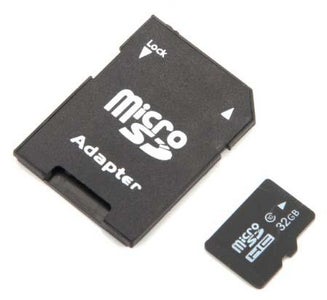

25. 1 - Card reader Arduino
26. 1 - SD card

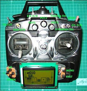

Step 2: Installation Hardware&Software
DIY PCB building

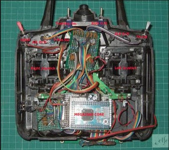

1.Installing electronic parts on DIY PCB according to electrical circuit diagram.(see in Github) 2.Install switches,joy stick gimbals,push buttons on transmitter body. 3.Wiring and connecting PCB - MEGA2560 - Gimbals - Switches - Push buttons according to circuit diagram.
Firmware installation (can do before hardware installation)
1.Downloading software OpenTx companion2.3.x from OpenTx website.
2.Installing OpenTx companion on PC.
3.Running OpenTx companion,downloading firmware by using OpenTx companion.
3.1 Edit setting menu - Radio type : DIY MEGA2560 radio
3.2 Build option - ST7920 - frsky - sdcard - more option as you want
3.3 Default Stick Mode(Futaba) - Mode3 (AIL ELE THR RUD)
3.4 Default Channel Order (Futaba) - A E T R
4.Flashing Arduino MEGA2560 by using usbtiny.
See detail of flasing procedure in Github.
5.Testing hardware post-installation.
