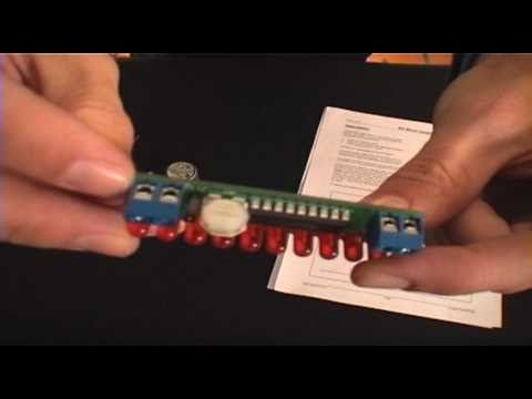

Boost your ability to see in the dark build your own LED IR booster for approximately $15.00 with this step by step instructional video !!! Find Most the parts at your local RADIO SHACK store!!
These IR boosters will works with any Sony HI8 Handy Cam Night Shot Camcorders as well as any DVR systems that user IR Cameras. A great addition to any Ghost Hunters paranormal equipment arsenal.
