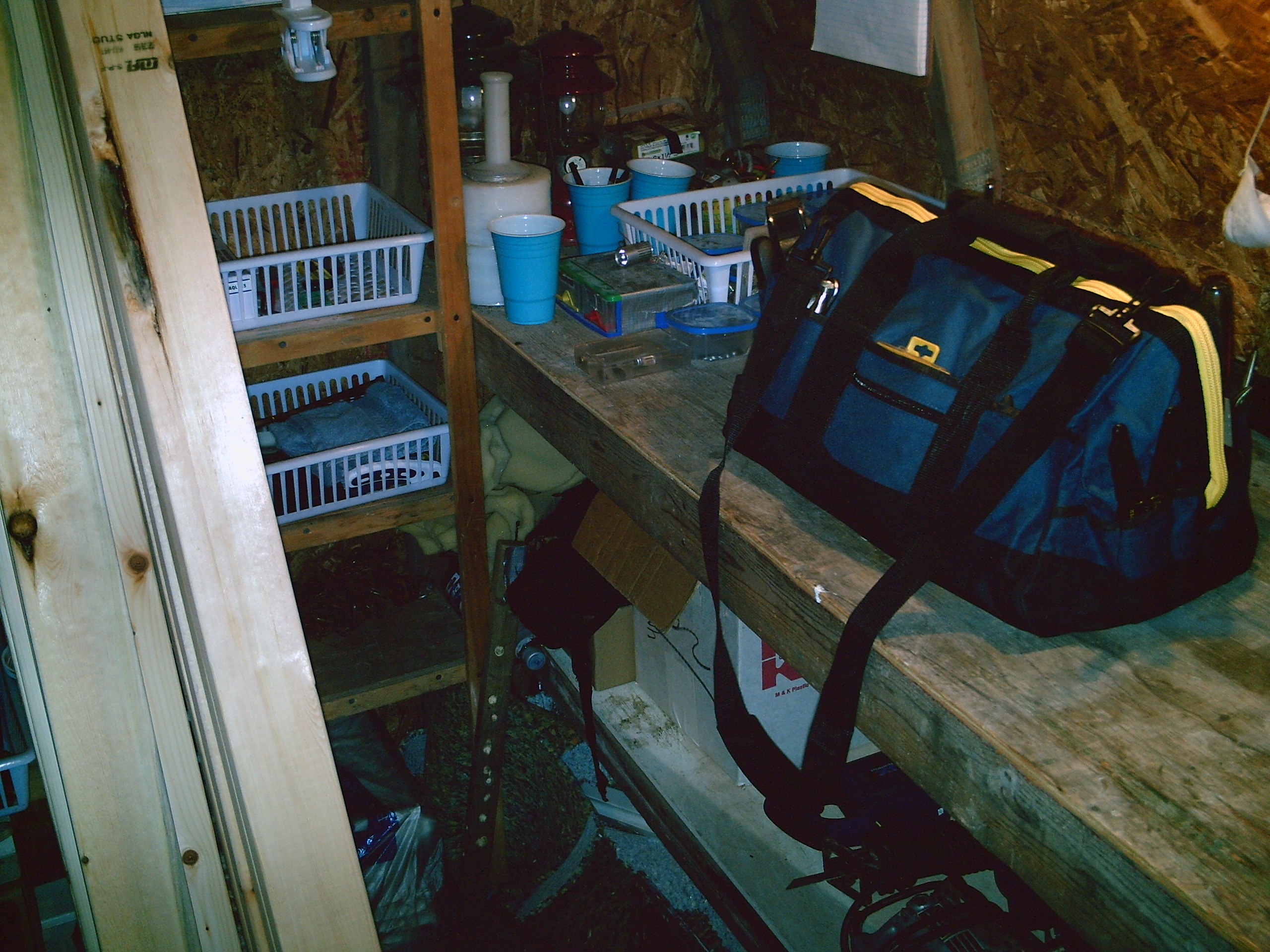

Step 1: Supplies and Tools
Tools:
Square
circular and/or hand saw
hammer or drill
tape measure
Supplies:
wood for risers
wood for runs (steps)
wood for risers unless an open riser staircase (see building code)
Screws or Nails
Draw a plan of your steps so you know what your measurments are.
