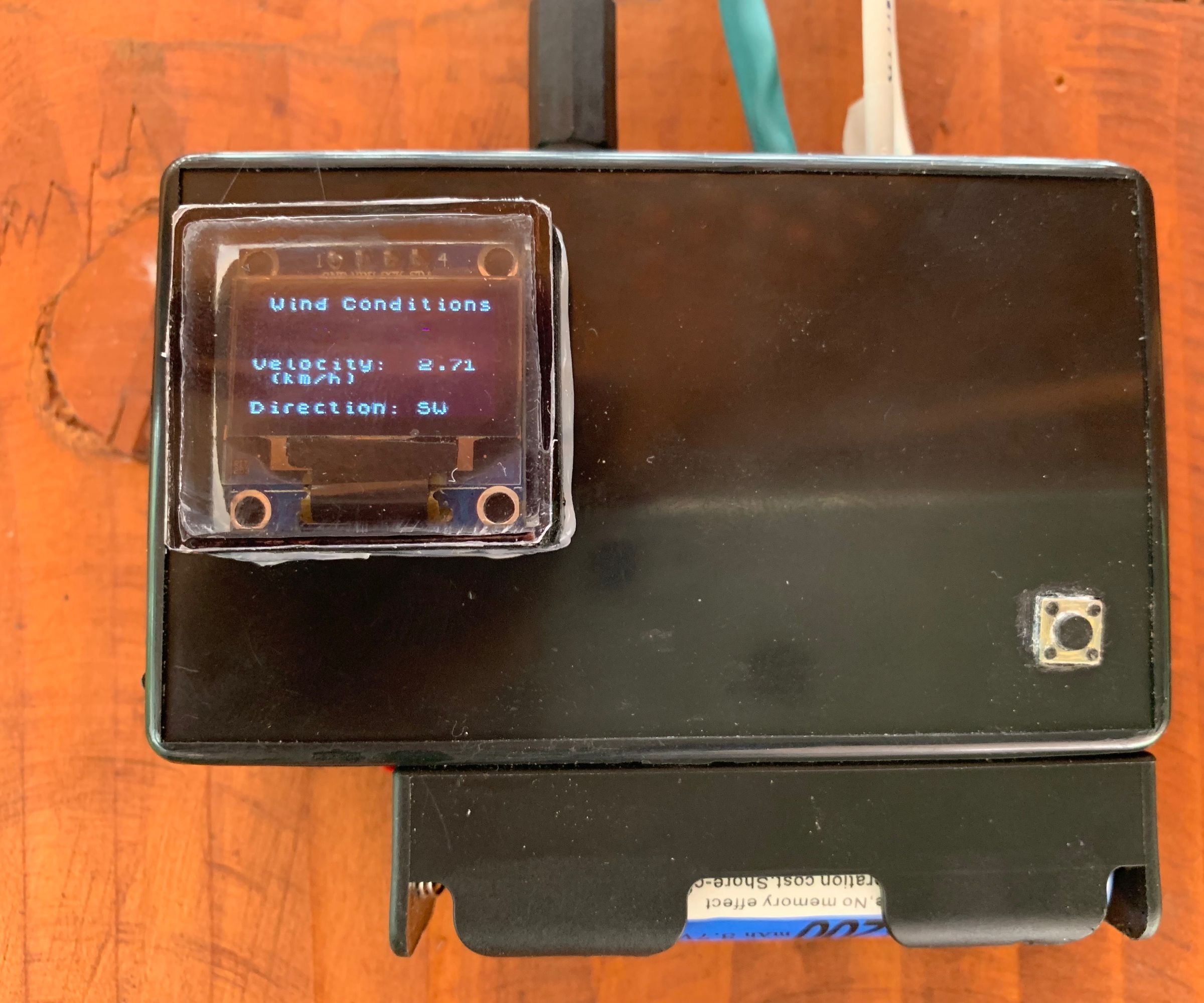

Step 8: Connecting Nodemcu and Installation
The diagrams show the correct connection of each cable.
To test the operation I used a 0.96 "OLED screen to read the measurements and verify that they are correct, connect the OLED in this way:
D1 - SCL
D2 - SDA
VCC and GND
To install on the ceiling the only care is to keep the whole device at the correct level. For that use a bubble level and many large screws. And do not forget to address the north of your anemometer for the geographical north of your compass. Otherwise, the direction of the wind will not correspond to reality.
