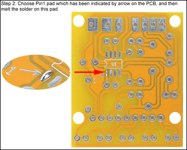

Step 2: Choose Pin1 Pad Which Has Been Indicated by Arrow on the PCB, and Then Melt the Solder on This Pad.
Step 3: Fix SC8002B
Step 4: Connect Others Pads on SC8002B to Pads on PCB by Tin and Soldering Iron.

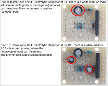

Step 8: Install 1pcs 470uF Electrolytic Capacitor & 2pcs 10uF Electrolytic Capacitor

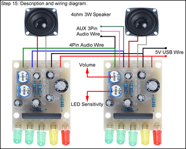

Step 12: Description and Wiring Diagram

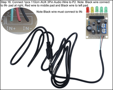

Step 13: Connect 1pcs 110cm AUX 3Pin Audio Wire to P2

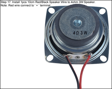

Step 14: Install 1pcs 10cm Red/Black Speaker Wire to 4ohm 3W Speaker
Step 15: Connect Speaker to PCB at P3
Step 16: Connect 1pcs 70cm USB Power Wire to PCB at P1 & Two PCB by 1pcs 70cm 4Pin Audio Wire on P1,P2 at 4pad : ‘+5V’ ‘GND’ ‘IN+’ and ‘IN-’

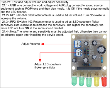

Step 17: Est and Adjust Volume and Adjust Sensitivity

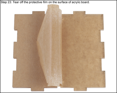

Step 19: Tear Off the Protective Film on the Surface of Acrylic Board.

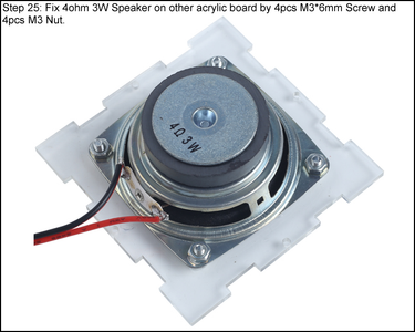

Step 21: Fix 4ohm 3W Speaker on Other Acrylic Board by 4pcs M3*6mm Screw and 4pcs M3 Nut.

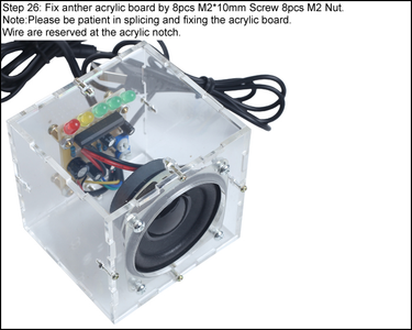

Step 22: Fix Anther Acrylic Board by 8pcs M2*10mm Screw 8pcs M2 Nut.
