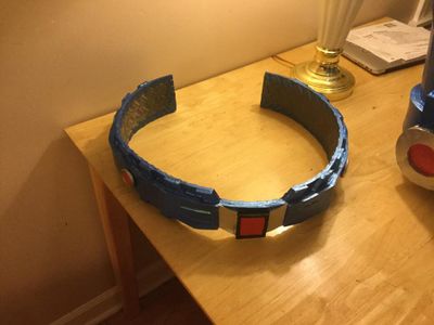

Step 1: Belt
1. using a tape measure, measure your waist line. Since this was a commission for someone in another state, i had them create a duct tape dummy in addition to giving me measurements.
2. Referencing the toy figure (pic 1), the main strip of the belt was made from EVA foam. I knew the buckle of the belt was somewhat lowered so i drew that first on some scratch paper and then transferred the design onto EVA foam. From there, i added some black thinner craft foam to create a raised buckle. and then one more level to create the middle square of the buckle. (pic 2)
3. To make the sides of the belt, i added another later of EVA foam. I used my exacto knife to cut a detail across the entire length of both sides. Then apply heat to that cut from the heat gun to expand it. then use a soldering iron to create grooves into the backside. This technique in the cosplay world is called "hills and valleys". Then i used the heating gun to create a detailed groove in the front. (pic 3)
4. You can now see what the "hills" look like once you added glue to the back side of the EVA and bent it at a slight angle. (pic 4)
5. glue the side pieces onto the main belt. Fill the gaps with kwikseal caulk. You can even attach your real plastic buckle to the back. The reason why the buckle is in the back is because pictures will typically be taken from your front, and they won't see the plastic black buckle. (pic 5)
6. now you can add your details. I added an EVA foam coin on either side.

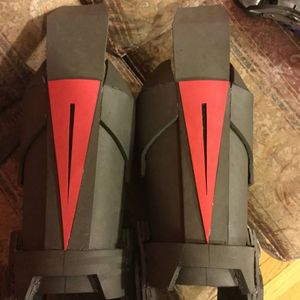

Step 2: Gauntlets
1) i measured from wrist to elbow and then created a shape that would be on the inside of the forearm. i curved it a bit to compensate for the wrist and the fact that the forearm is thicker than a wrist. (pic 1) i usually draw a template out of paper first to use as a guide, since you technically need two of these.
2) then i created the top layer. I knew that the gauntlets covered the hands as well, so now i measured from fist to elbow. i curved the eva foam on a bowl using a heat gun so that it was rounded at the end. (pic 2)
3). i knew that you could see the inner side of the gauntlet around the fist. I didn't want the "Tread" of the EVA foam to show so I covered it with smooth black craft foam. If you have a sander, you could technically sand all the tread off instead. I put a little bracer in the middle to help when i glued it to inner EVA gauntlet piece from step 1. (pic 3)
4)Then, i glued both pieces from step 1 and 2 together. i made the circumference of the gauntlets a bit larger because thats how the figure looked.(pic 4)
5) then i used an exacto knife and cut a slit down the inner part of the gauntlet and added small plastic buckles along the seam. also, you can cut out a section for where your arm bends. (pic 5)
6) now to start adding layers and buttons. I wanted to make the gauntlets big and bulky so i added a few more laters. i started by adding another curved section to the top front of the gauntlets. Start with paper templates, cut, and then glue them onto the gauntlet. (pic 6 and 7)
7) now you should have your gauntlets and belt. (pic 8) don't forget to seal all gaps with kwikseal
