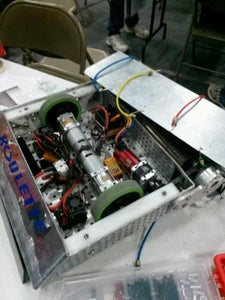

Have you ever wanted to build a robot built for destruction? This instructable will show you how to build our succesful bot, Roulette. Don't let the title fool you, it may be electric but this battery powered beast was tested using past bots. We knew we had a winner when it tossed an old bot 6 feet in the air. This build should cost less than 500$ if you already have the tools. You can watch a match of Roulette here:

Step 4: The Frame
Using the layout provided in the "Design" step, take your material and cut it to match the image and dimensions provided.
Or if you walk to the beat of your own drum, cut out your own layout. There are also other styles of joining pieces, our newest design bolts together instead of requiring bending, but it does require a CNC mill instead. Fold together designs are the easiest to make, also make sure all the components we will be adding later on will fit in your layout, our layouts are usually 12in x 12in to make sure everything will fit without a doubt.
If you folded everything correctly and you followed the provided layout, you should now have the frame of the bot and it should have 2.5in sides and a front wedge to match. At this point you can weld the corners to solidify the frame, if you don't have a welder, you don't have to weld these corners they are pretty strong without the welds. However, if you plan to compete with this design, it might be a good idea.

Step 6: Adding Components
You will have to find a way to mount the motors whether it be a gearbox like we use or a direct drive system. You will also need wheels of some sort to roll on. We use Banebots green wheels, they are designed for high traction. We also use banebots 20:1 gearboxes for drive systems and 4:1 gearboxes for our weapon system. We use bolts to hold our gearbox in place, all the other components are velcroed down with high strength Velcro. You will have to drill holes into the frame to accommodate a banebots gearbox. If you already know how to wire an RC system you're one step ahead, if not follow this tutorial on RC wiring: https://www.instructables.com/id/How-to-install-ele...
