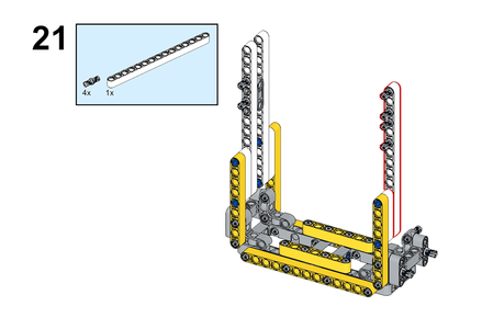

9. Now start to build the fixed bottom columns on both sides, using 9-hole beams and long pins.
10. Fix with the 5-hole beam.
11. This step is to build a permanent station to extend the height.
12. Insert the double bolt connector, which is to be fixed with the other side of the long beam.
13-15. The steps are the same as 9-11 so that the two sides of the long column have been fixed.
16-25. The steps are the same as 9-15 so that the two opposite long columns have also been fixed.

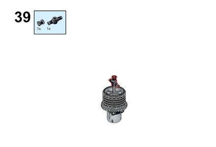

33. Begin to build the part of the person riding the wheel, the steel ball into the universal wheelset, the steel ball has a certain weight, used to increase the balance.
34. Fixed with shaft and coupling.
35-38. To make the center of gravity more stable, add wheels also to increase the weight.
39. Add the bolt connection and the cross bush to form the bottom.
