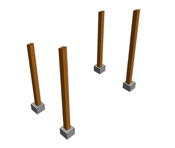

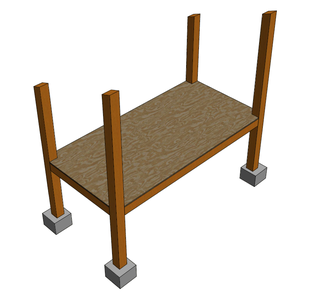

Step 1: The Foundation
Since our coop is 3 ft. by 6 ft., we measure that out on the ground and place our footers, stone or concrete pads, where they are centered on these measurements. This will help to provide a solid foundation for our coop.
Step 2: Cutting the Corner Posts
Next, we cut our corner post which will by 4-inch by 4-inch stock. Since our coop will have a slanted roof to help with water runoff, the front posts are cut three inches taller than the back posts. The shorter posts are cut to lengths of 52-inches and the front posts are cut to 55-inches. All four will have the ends cut at matching angles.

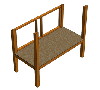

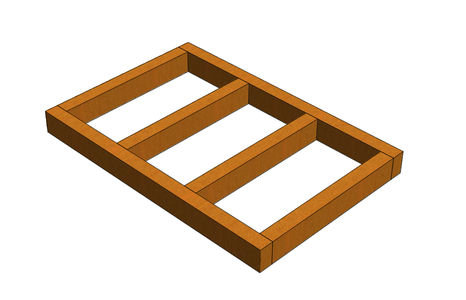

Step 3: Building the Floor Frame
In step three, we will add the floor. Start by measuring the distance between the front and back post. Measure and cut the length of the boards using 2-inch by 4-inch boards, these will be flush with the front of the posts. Next, measure the distance from inside of the boards you cut first. Mark and measure on your board stock and cut seven boards of this size. Nail or screw one of these shorter boards onto each end of the longer boards. Just remember to keep the smaller boards on the inside of the longer ones. Space the remaining five boards evenly and secure in place.
Now that the main section of the flooring studs is finished, measure the distance from the ends to the outside edge of the posts. Cut braces for these measurements then measure and cut for the distance between the posts. This will provide support for the outer edge of the flooring and make the structure more stable.

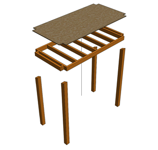

Step 4: Apply the Floor Sheeting
Once all of the boards have been cut and attached, measure the floor area and footprint onto a sheet of ½-inch plywood. Cut and then place the plywood on top of the framing, then nail or screw in place.
*Tip = There are two ways you can go about building the floor.
Either build it as you go by attaching everything together as you cut it or building the entire floor first and then attaching it to the posts. This last option, however, will require the help of some friends as the floor will be heavy and trying to hold it in position while you attach it will be very difficult. It will need bedding later on as well.

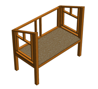

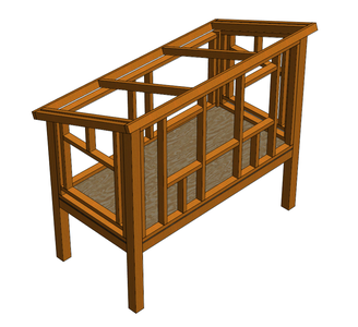

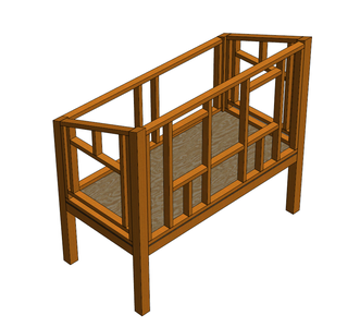

Step 5: Framing the Back Wall
Now that our floor is completed, we can start framing the walls of our coop. Starting from the back of the coop, measure the distance between the back posts and cut two boards of this length, one will be on the bottom while the other will be on the top. Then, measure the inside distance between those two boards and cut four boards at that length. Attach two on each end, against the posts, and the other two in the center and with a 4-inch space in between.
Step 6: Framing the Side Walls
Now we can frame the side walls. Begin by measuring and cutting boards for the sides and for across the bottom and top. Remember to keep the angle when cutting for the top. Once that is done and attached, measure and cut another board that will run horizontally and about 3-inches above the bottom board. Measure about 2-inches from the sides and then measure the length from the board you just cut and attached up to the top board. Once measured, cut, and attached, cut another board to run horizontally between them leaving a 12-inch opening. Cut another brace and attach it to the center of that board. Repeat this process for the other side wall.
Step 7: Framing the Front
Now frame the front wall as shown in the image. Leave three openings that are roughly 8-inches by 8-inches. The bottom opening will serve as a way for your chickens to get in and out of the coop while the top two let fresh air and light inside.

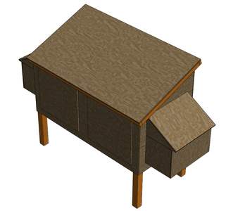

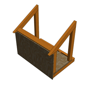

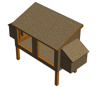

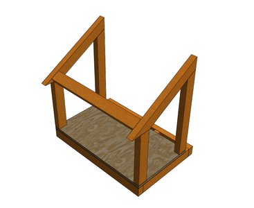

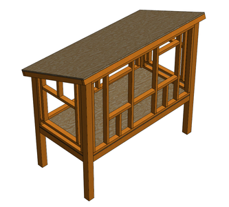

Step 8: Framing the Roof
With all of the walls now framed, you can begin building the frame for the roof as pictured. Ensure you leave an overhang on all four sides to help keep rainwater from finding its way into the coop.
Step 9: Applying the Sheeting for the Roof
With the roof framed, you can now measure, cut, and attach the plywood to the roof. Try to keep the edges of the plywood as flush as possible to the outside of the framing. While a little overhang will not hurt anything, cutting it too short could let water inside of the coop.

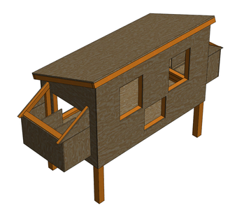

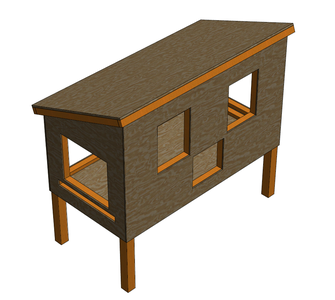

Step 10: Adding the Exterior Sheeting
With the roof completed, you can move on to applying the outer shell of the coop. Measure and cut out for all of the openings. Additionally, you will notice the slot that has been cut out on the sidewalls, these will come into play in our next step.

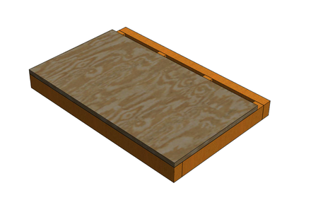

Step 12: Nesting Box Floor
With the frame done, you can now attach the plywood sheeting. Notice how the plywood does not go all the way to the end? This is so it can slide into the notch on the sidewall of the coop. Leaving it about 3-inches short should be plenty of space.

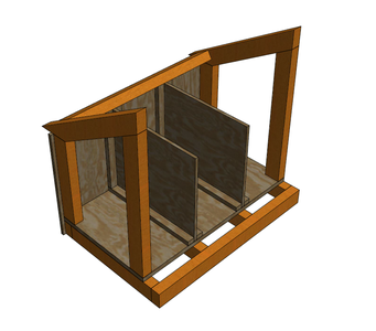

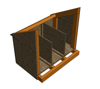

Step 15: Building Dividers
Your chickens won’t like it too much if their roommates are always in their business. Evenly measure for 3 spots. Make some cleats with the plywood and then make some dividers to slide into them.

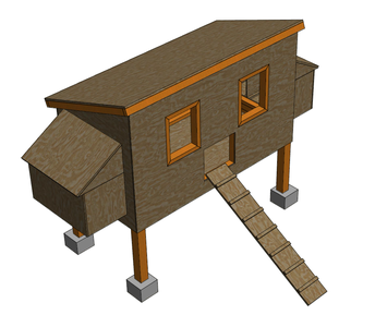

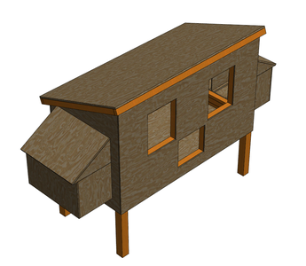

Step 22: Build a Walkway
For our final step, make a walkway for your chickens to use to get in and out of the coop. This can be done with the plywood you have leftover or with other materials. Just make sure you attach cleats so your birds can make the climb.

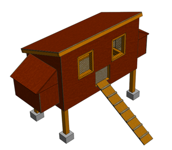

Step 23: Finishing
There you have it, 22 easy steps to building your own chicken coop. Feel free to add any features you think you and your birds will need.

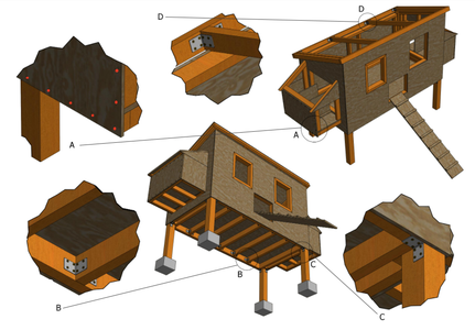

Step 24: Diagram of Fastening
I'm also attaching a diagram of fastening.
