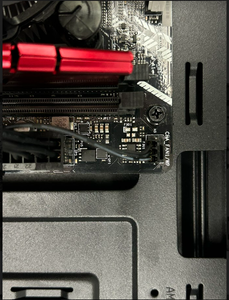

Now we put in the RAM (random-access memory) make sure you have the notch is lined up with the notch in the motherboard ram slot then push down and if you have it correct way it should go in without much force.

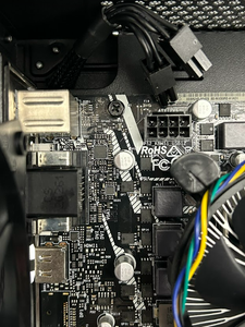

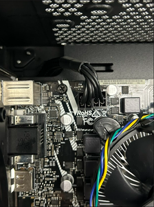

Second we'll plug in the 4/8 pin connector which powers the brain of our computer the CPU

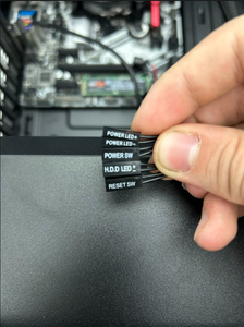

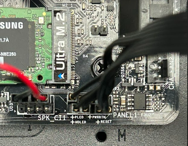

Third we'll plug in the front panel connectors, we need to make sure we have everything plugged in correct or it won't work

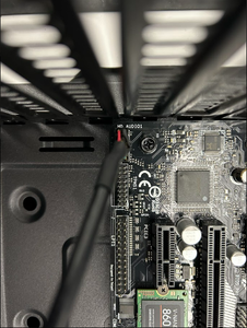

Lastly lets make sure the audio connectors and the fans

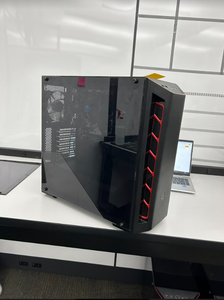

Step 6:
Last plug it in and make sure everything works
