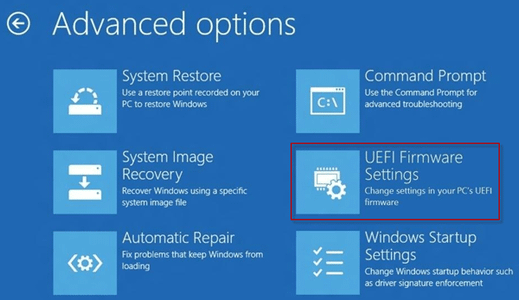

Step 12: POST/BIOS
POST is a power-on self-test. It's during this time that if everything is working correctly, you'll hear a single beep from your system speaker. If you start up the computer with no RAM, it will emit a series of beeps.
BIOS is basic input/output system. It's a type of firmware used to perform hardware initialization during the booting process (power-on startup) on IBM PC compatible computers, and to provide run-time services for operating systems and programs. The BIOS configuration settings are saved within the CMOS.
The UEFI is kind of replacing the traditional BIOS, seeing as it's more friendly to the eyes/more user-friendly.
