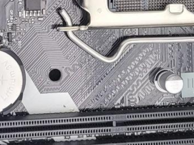

Step 3: Installing the CPU
The third step to building your computer is to install your CPU. Place the motherboard on a surface, (preferably on the box it came placing it on a desk will work) and locate the CPU socket, this is a good chance to make sure you got a compatible CPU. If you got and Intel CPU the pins should be on the motherboard, (we will be using Intel) the pins look like thousands gold pins surrounded by a silver metal bracket, Ryzen CPU's have those pins on the already on the CPU. next the the silver metal bracket there should be a lever about the length of the metal bracket, lift this around the ledge it is under and up, this should unlock the bracket so you can lift it up. pick up your CPU making sure to only handle by the sides, don't touch the bottom of the CPU (the gold contacts). Locate the gold triangle on the corner on the CPU, this will line up with the indented tringle on the motherboard, make sure you have found both of these things before continuing because if you install your CPU incorrectly it could ruin the CPU forcing you to replace it. Once you have found both of these things gently lay the CPU onto the gold pins making sure it fits snug, you will not need to apply any pressure to install, simply place it into the socket, wiggle the CPU a slight bit to make sure it is sung. Once you have the CPU in the socket lay the metal bracket on top of the CPU, making sure that it lays flat on top of the CPU. Pull the lever down and under the metal bracket to lock the CPU in place, this may take some force so don't worry.

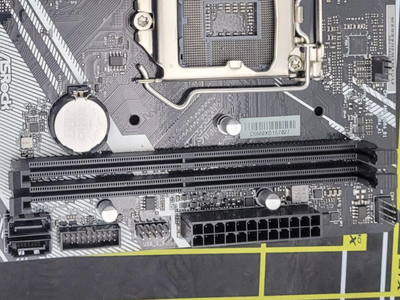

Step 4: Installing the RAM
The forth step is to install the RAM. Locate the long slots on the motherboard and normally next to the CPU slot, some motherboards have 2, some have 4, some have 8. depending on how many you have, it will determine what slots to put your ram in. The amount of RAM you have will also determine this. If you have 1 RAM stick you are going to need to install the RAM into first slot, if you have 2 RAM sticks you want to install them into the 2nd and 4th slot on your motherboard if you have 4 slots for RAM. if you have 2 slots you install them in the first 2 filling up both slots. In our case we have 2 slots with 1 RAM stick which means we are going to install our RAM into the first slot on our motherboard. Locate the little notch in your RAM stick that will fit in with the notch on your motherboard slot, different versions of RAM such as DDR5 or DDR3. may have this notch in a different spot, make sure this aligns when installing the RAM. push down the levers on both sides of the RAM slot, some motherboards may only have one lever to push down, if so, only push down the one side. Place the RAM slot into the slot with the correct orientation. If installed correctly you should be able to simple push down evenly on both sides of the RAM stick and hear and audibly clicking sound as it clicks into place, you should hear 2 clicks.

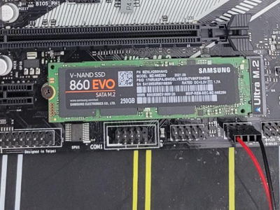

Step 6: Installing the Storage
Step 6 is to Install the storage. The first thing you want to do is figure out what type of storage device you have. there are 3 different kinds of storage devices, there is HDD's, SSD's, and NVME SSD's. we used a NVME SSD, so I will give instructions on that. First Locate 4 things, your NVME SSD, your standoff screws for the storage, and installation screw for the storage and the socket the storage goes in on you motherboard. Once all of these have been found you need to slide the storage with the gold contacts going in first, it should only go in one way. After that you need to grab your SSD standoff and put it into the correct length of your NVME SSD, push the SSD on top of the standoff and screw it in with the SSD screw.
