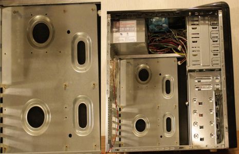

Step 1: Step 1
Directions:
Open case, this case has to have both sides opened (Case already has power supply installed.)
Front Panel
Remove both the thumb screws on the back of the case. Slide the panel back about ½” then tilt the top away from the case and lift panel off.
Back Panel
Repeat above instructions.
Most cases are similar to this case, however, some can be easier or harder to remove the side panels
Front Panel
Back Panel
