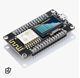

  1. ESP8266 with OLED display

The ESP8266 is a low-cost Wi-Fi microchip that enables internet connectivity for IoT projects. The OLED display is a small, low-power screen that shows visual data, often used for displaying sensor readings in real-time.
