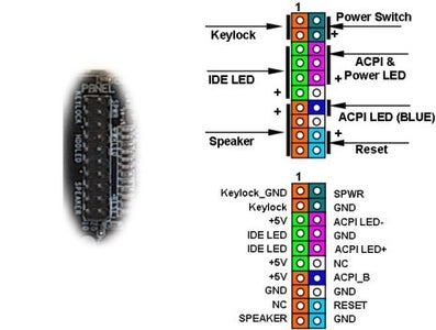

Step 11: Other Connections
You may have noticed unidentified cords zooming in and out of the previous pictures.  These cords are the case to motherboard connections and control things like LED's, the power/reset button, USB ports etc.   These connections vary so widely from case to case and motherboard to motherboard that the only way to make them is to consult your manuals.  I have included a picture of a typical motherboard - case connection chart to show you what to look for.
Once you have located these instructions in the manual, it's a matter of reading the wires coming out of the case and placing them on the correct motherboard pins.  This step can be frustrating as the pins are very small, but is necessary to implement all the features of your case.
