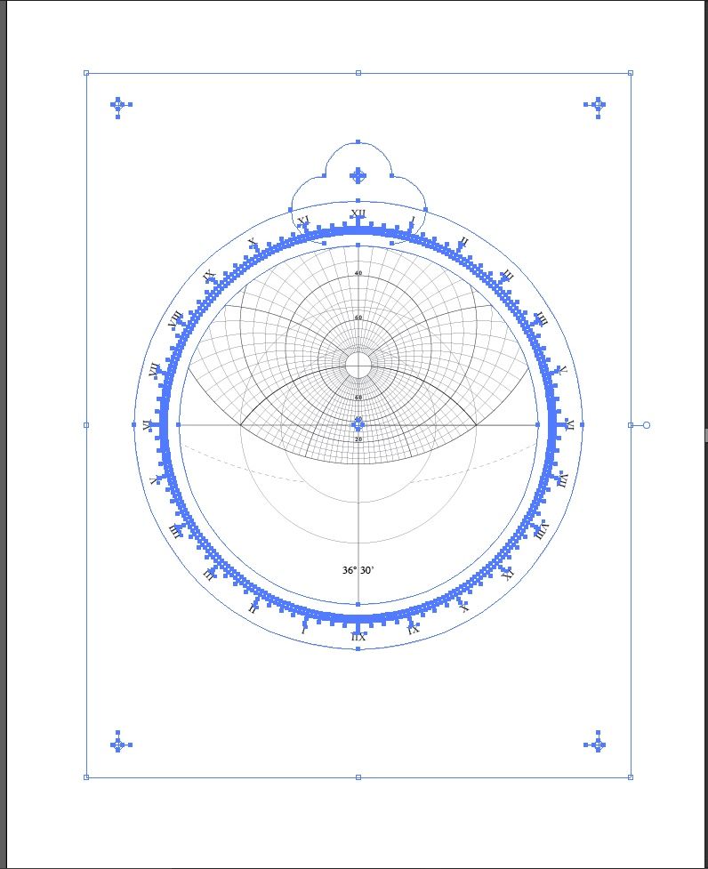

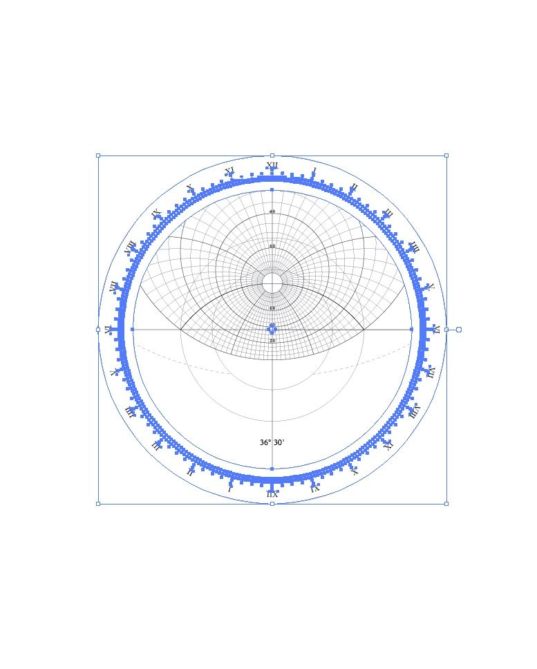

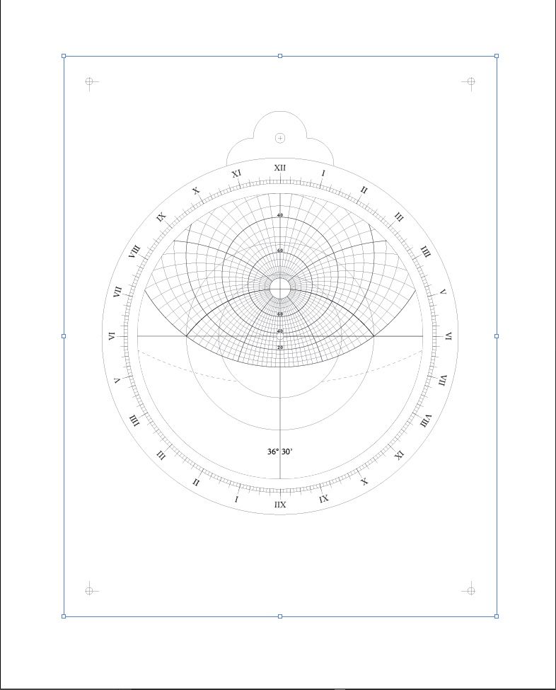

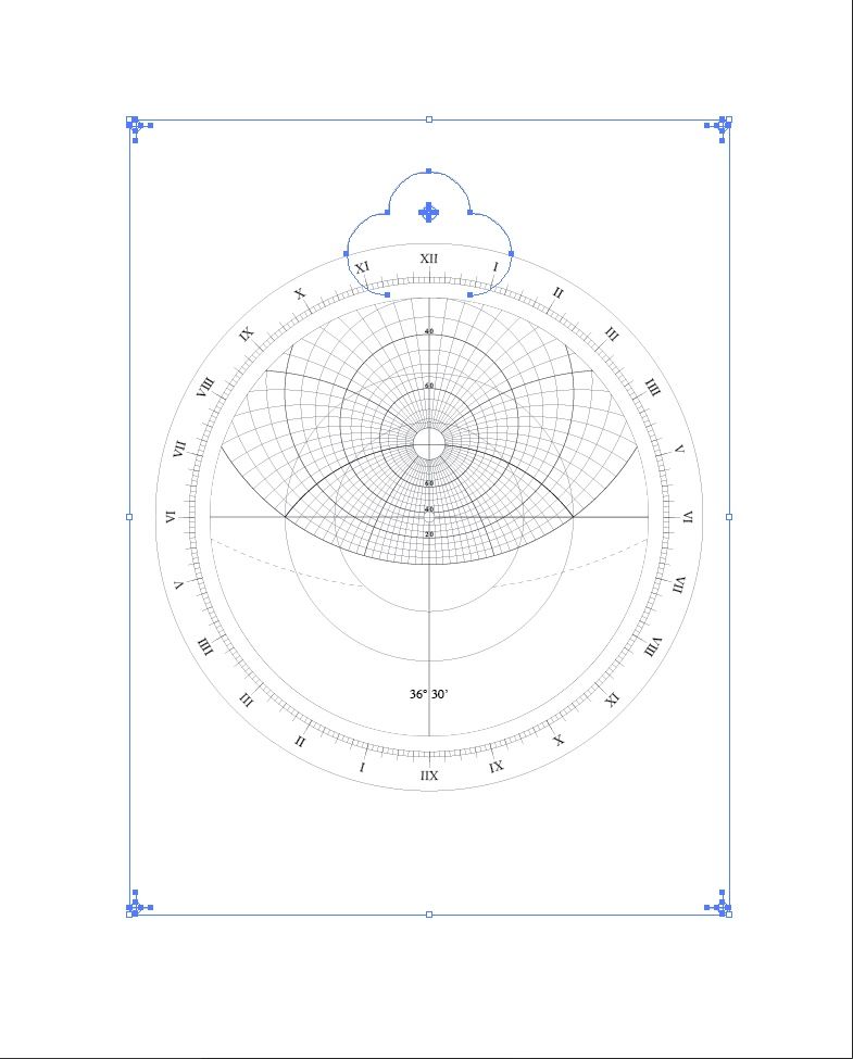

  1. Open the “front_back_template.ai” file in Adobe Illustrator.
  2. Import the "AstrolabeFront.eps" file you created from the AstrolabeGenerator softwares in two steps ago into Adobe Illustrator into a new Illustrator window. We will be making some modifications to this graphical element before we merge it into the template.
  3. Using the arrow tool and the mouse, select everything in the frame.
  4. Under the object menu, select "Ungroup".
  5. Use the arrow tool to select the outer transparent frame, and delete it with the delete key.
  6. Select the registration mark using the mouse tool. This will also include the “crown” of the astrolabe from the EPS file. Delete the registration marks and the crown.
  7. Select everything.
  8. (OPTIONAL) You MAY wish to change the point size of all the lines to 2. This darkens the lines for the etch and makes it a bit easier to read. You can also modify the fonts to a different type to make the etched acrylic a bit easier to read. These changes aren't critical. You also might wish to add other graphical elements to the design. If you want to add "Happy Birthday!" with a large picture of a llama, this is the time to do it. If you do customize the project, try to avoid adding more elements to the altitude-azimuth grid so you can still track the stars!
  9. Select "Group" under the Object menu.
  10. Rotate this object by -90 degrees by selecting Object->Transform->Rotate.
  11. Copy this object using the Edit->Copy.
  12. Go back to the "front_back_template.ai" window. Paste the object with the the modified astrolabe front from your buffer into this template (Edit menu -> paste).
  13. Move this object to the back of the drawing using Object->Arrange->Send to Back.
  14. Move the astrolabe front you just pasted into the document so it is aligned with the bottom template. There should be a small space between the template and the Front.

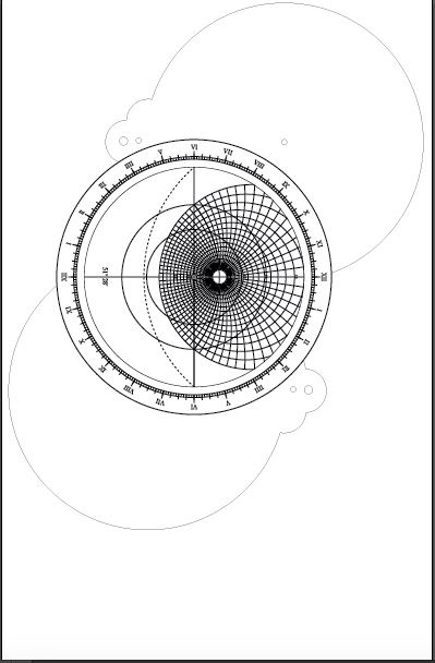

  15. Repeat steps 1 through 14 with the back of the astrolabe with two modifications:
    1. Rotate the astrolabe back by +90 degrees, not -90 degrees in step 10.
    2. Align the astrolabe with the upper template.
  16. Use the "Save As" option to save this as "astrolabe_front_and_back.ai". You can close the EPS files if you wish at this point.

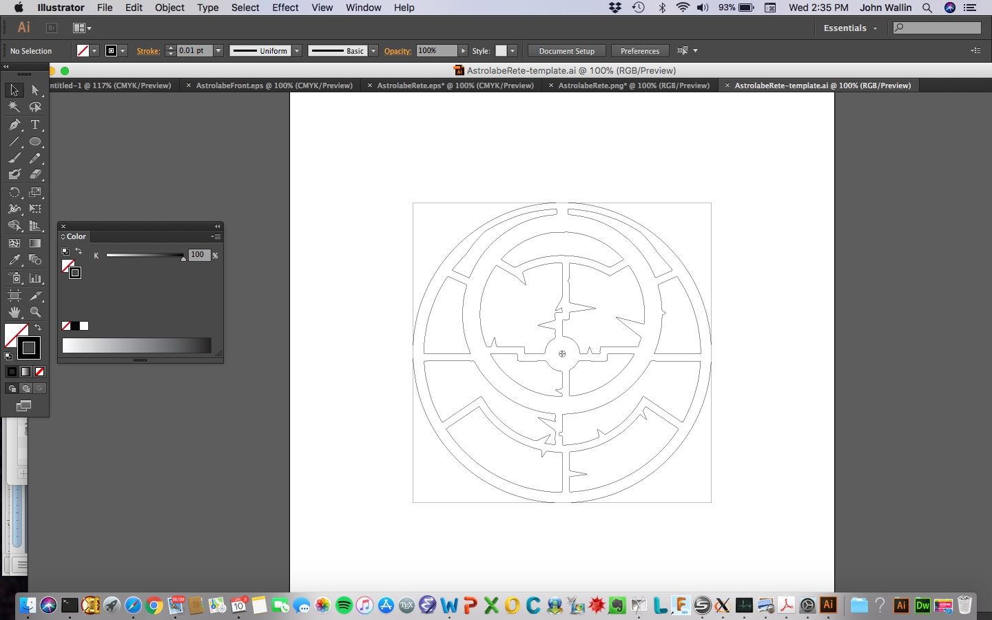

Step 7: The Rete of the Astrolabe, the Rule, the Alidade, and the Stand
The other pieces you need to engrave and cut for the project are the Rete, the Rules, the Alidade, and the Stand for the Astrolabe. Since all of these elements don't change between locations in the northern hemisphere, you can use the “rete-and-stand.ai” file I provided for this part the project. If you live in the southern hemisphere, you will need to do some customization of the project. Jump to optional step 11 if you need to make a custom rete.
Here is a short summary of these parts and their function:
  • The rete of the astrolabe is used to represent the positions of stars in the night sky. Because the early astrolabes were made of brass, they used a lattice framework with arrows to point to the location of stars. In the standard version of the astrolabe produced by Richard Wymarc’s software, this characteristic shape is produced. I think this lattice work is the coolest part of this project, but you can use the “Modern Rete” option from his software and put it on a transparent disk if you wish. If you do this, you will need to just make a simple cutting circle around the modern rete so the laser cuts out the correct parts of the plastic.
  • The alidade of an astrolabe is the pointer on the backside of the device that is used to determine the angle a star has above the horizon. It is also used to determine the Sun's location in the ecliptic.
  • The rule of an astrolabe are the straight pointers used on both sides of the device to make sightings of the stars and align the device to the correct times. Rules often have degree markings on them to determine the astronomical declination of objects. For this template, there are actually two rules (with the measured degree marks) and two Alidades.
  • You only need one rule and one alidade for this project, but I put in a couple extra because there was plenty of room on the 11x14 piece of acrylic.
  • The stand is just a simple acrylic stand to display this project.

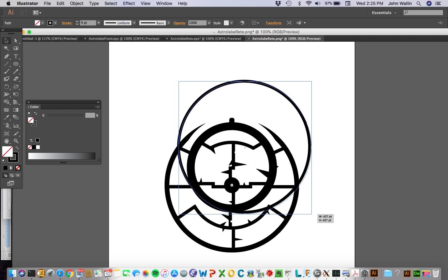

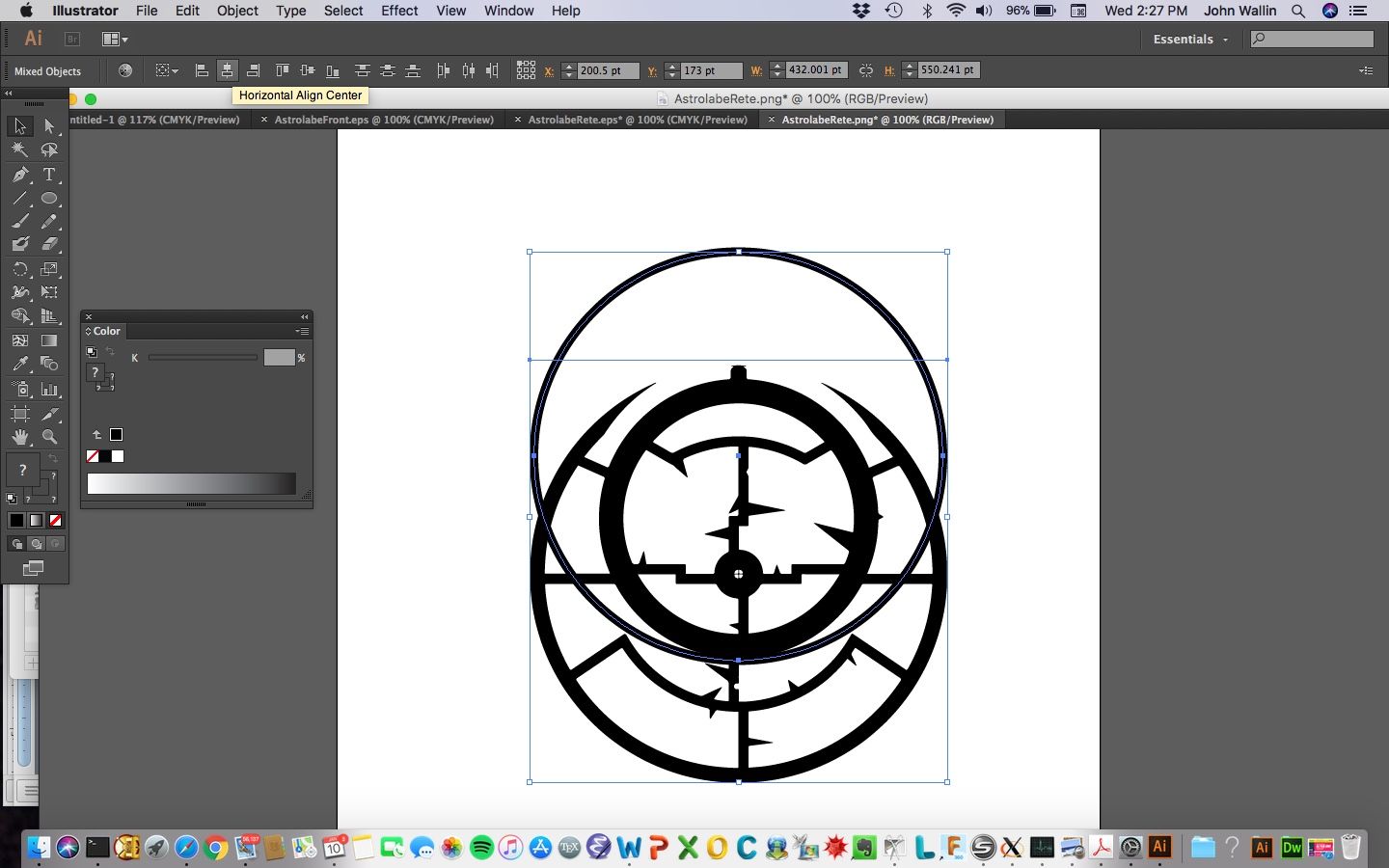

If you want to learn how I made the cutting template for the Rete, take a look at the optional instructions in step 11. If you are in the northern hemisphere, you don't need to do this. However, I thought adding this step might be helpful for people wanting to make cutting templates around vector graphics in Adobe Illustrator.

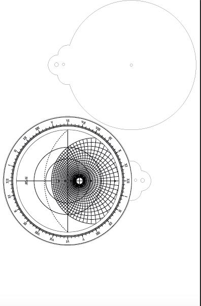

Step 8: Etching and Cutting the Parts
You should have two files that are ready to be etched:
  • rete_and_stand.ai
  • astrolabe_front_and_back.ai
These are both ready to be sent to the Laser Etcher. Let's start with the rete_and_stand.ai file.

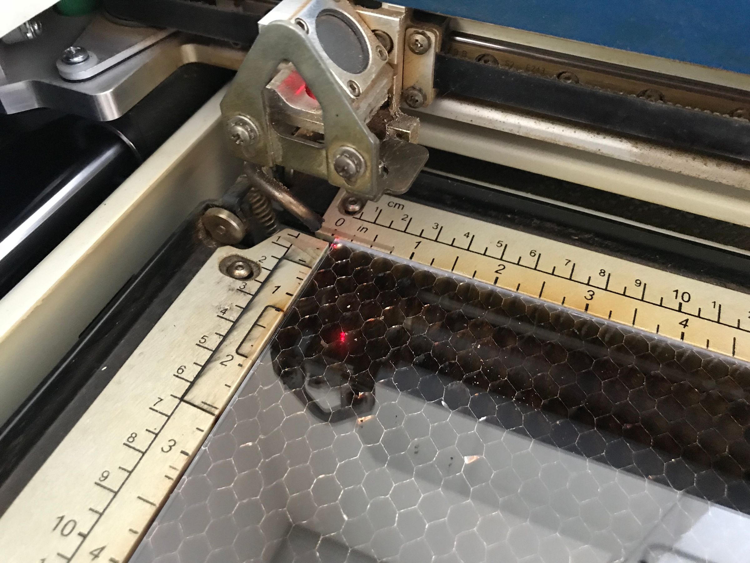

  1. Turn on the laser system. You may wish to run a piece of scrap material in the laser etcher with a small test pattern to make sure the laser is warmed up.
  2. Take the plastic cover off of the first 11x14 piece of acrylic.
  3. Place the acrylic in the laser etcher.
  4. Zero the home location of the laser to the upper left hand corner of the acrylic.
  5. Focus the laser. I prefer to use the manual focus setting, but this is entirely up to you..
  6. Close the top of the laser etcher.

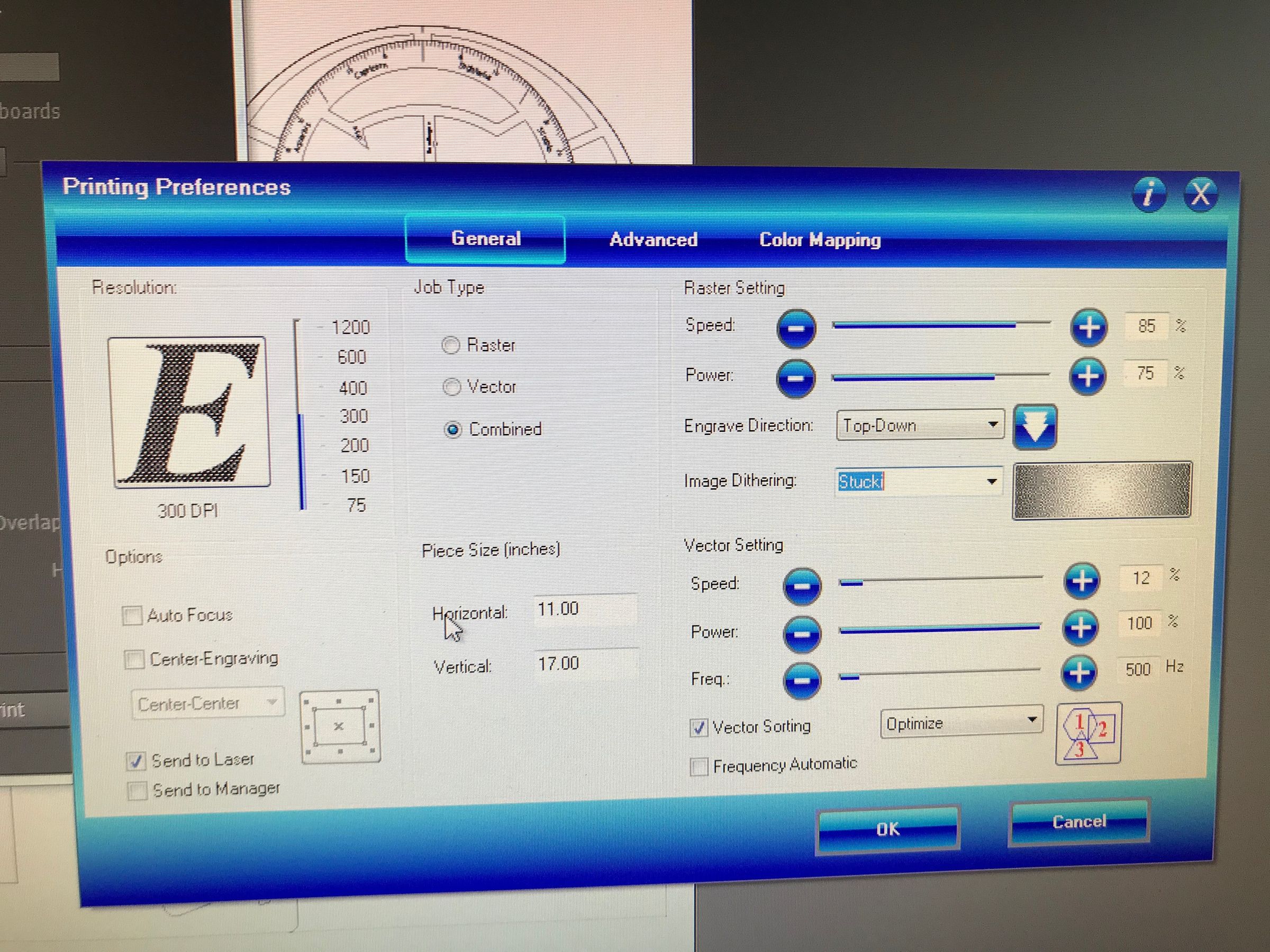

Set up the print job
In general, you just need to do the basic settings recommended for 1/8 thick acrylic. I used the following settings with our Epilog 40W Helix system:
  1. Go back to your files in Adobe. Select print from the file menu.
  2. Go to the setup menu so you can adjust the laser settings.
  3. Set the document size to 11x17 inches. The actual acrylic size is 11x14, but this was not a standard setting available in my print menu. I set the art boards to 11x17 to match this setting, but just kept the design with in the 11x14 inch limits of the acrylic.
  4. Set the Job Type to Combined
  5. Set the resolution to 300 or 400 DPI.
  6. Set the Dithering to Stucki
  7. The raster settings were set to a speed of 90 and a power of 75 for my laser etcher, but use the settings recommended for acrylic for your matching.
  8. The vector settings were set to a speed of 12 and a power setting of 100 for my etcher. Again, use the settings recommended for your machine.
  9. Click ok on the settings dialog box, then press print to send the file to the laser etcher.
    (Note: the raster setting hasn't been adjusted yet. Make sure to use the settings for your machine.)
The laser etcher should be ready to go! Press print to send the file to the laser etcher.

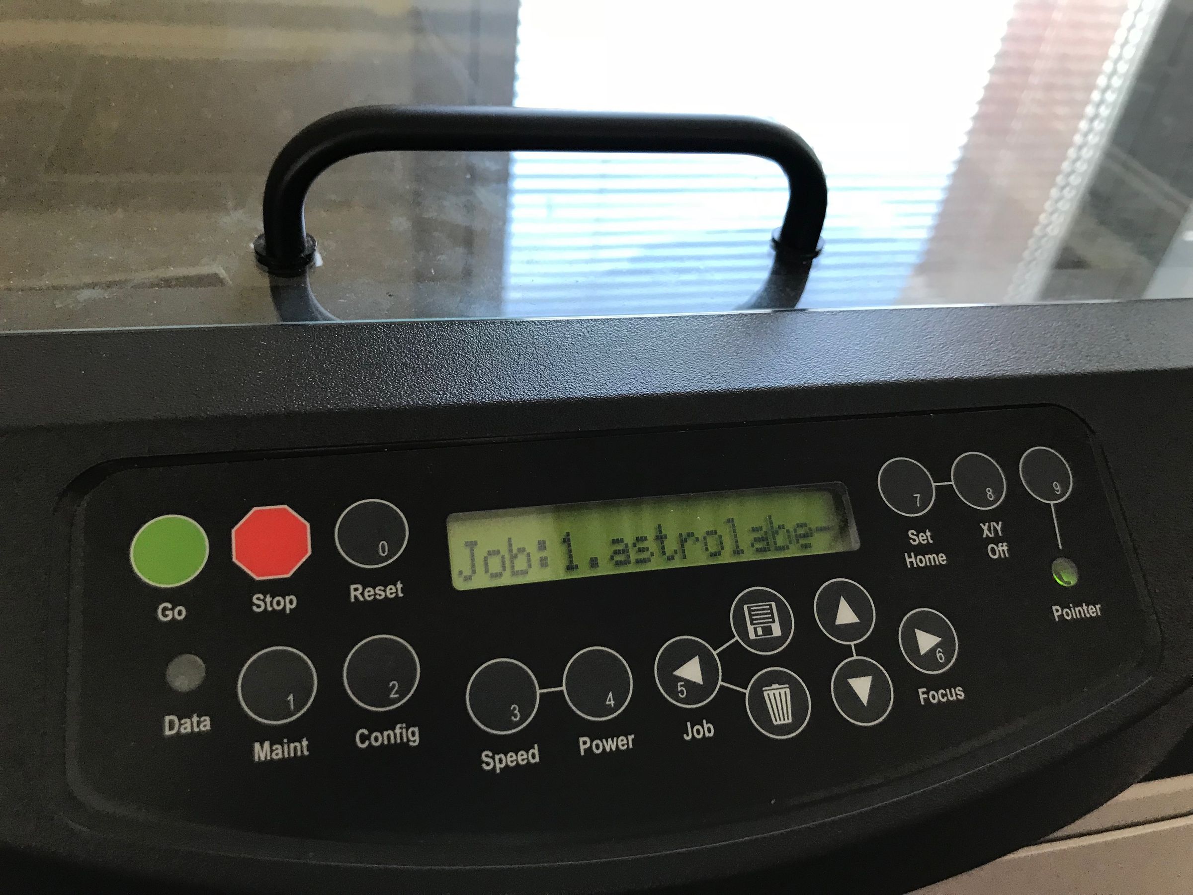

Etch the Acrylic
  1. Make sure the file has arrived in the laser etcher.
  2. Turn on the air compressor that is used to suppress any flames from cutting.
  3. Make sure to turn on the air filtration system. Acrylic is stinky!
  4. Press GO!
It should take about 20-30 minutes to etch these file using an Epilog 40W laser. When it is done, let the smoke clear through the filter before you open the etcher. Remove the parts and the waste from the etcher.

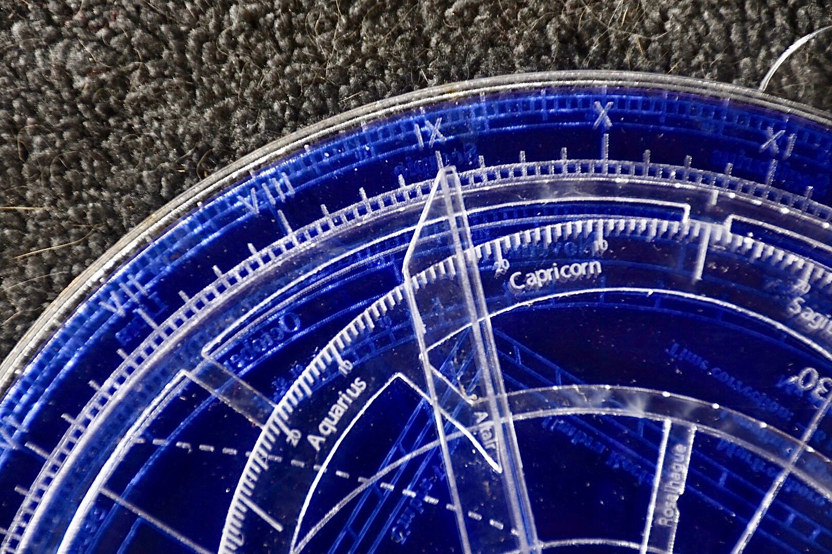

Step 9: Assembling the Astrolabe
Putting it together
Assembly the astrolabe is really easy. You should have a pile of plastic pieces from your laser etching, two thin pieces of Avery plastic dividers, and the #6-32 hardware you purchased.

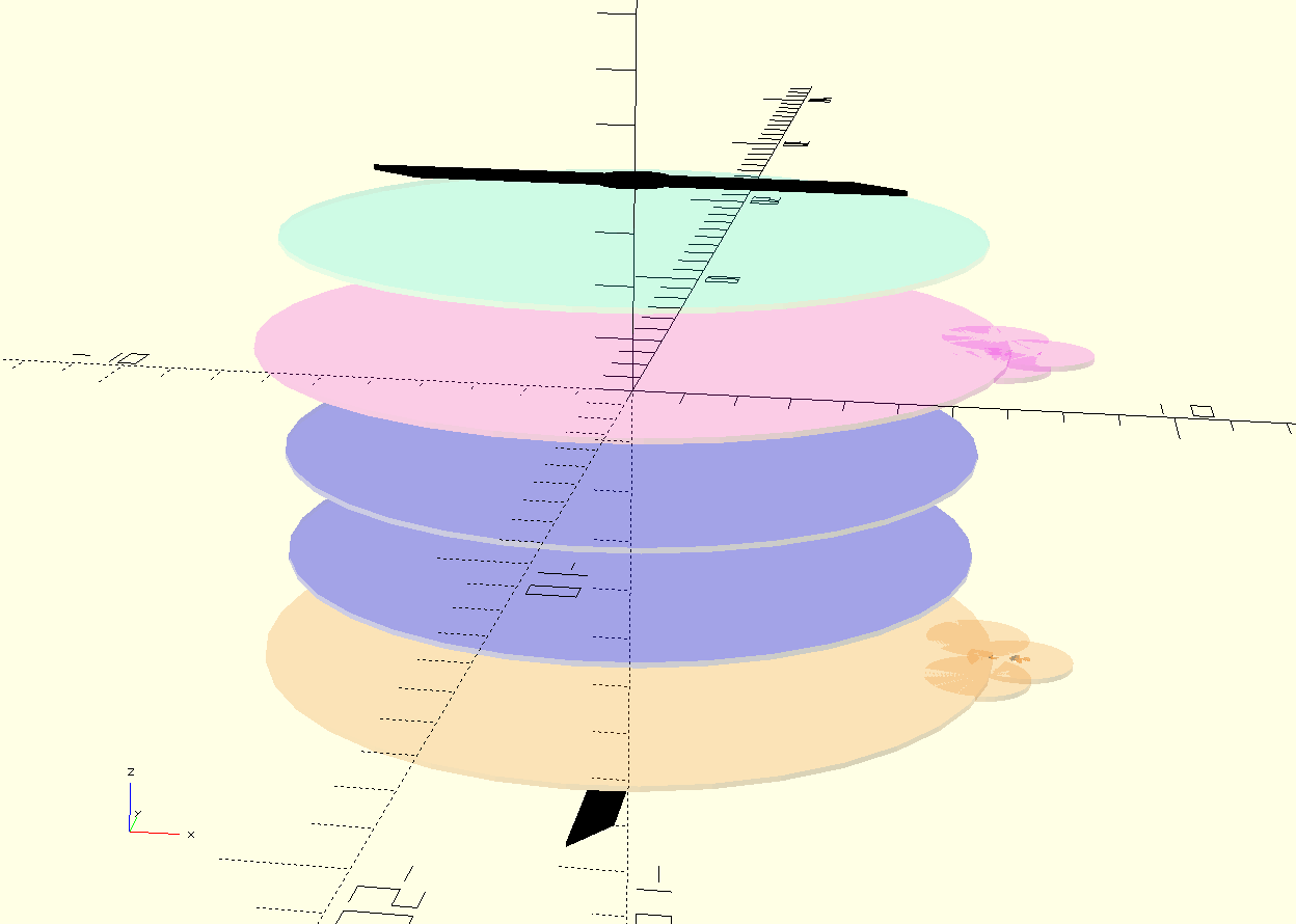

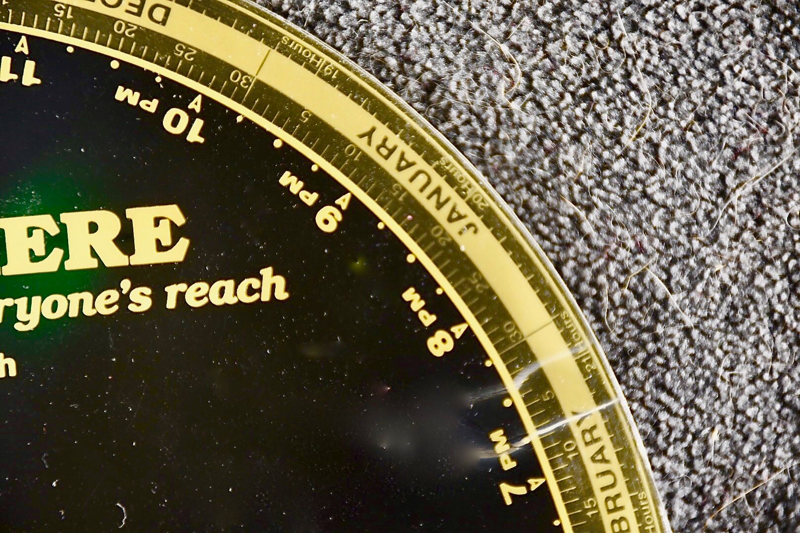

The order to put the pieces in is:
  • The Rule (the pointer with the markings on it)
  • The Rete (the spidery assembly with the star positions)
  • The Front
  • The two pieces of Avery plastic
  • The Back
  • The Alidade
This diagram shows the order of assembly. Make sure you can read the text is facing outward for each piece so it is readable.
Use one of the 3/4 inch screws and a locking nut for the center hole. You may wish to use one washer in between the screw head and the plastic and the locking nut and the plastic. You want to tighten the screw just enough so that the rete, the rule, and the alidade all rotate smoothly with a gentle push of your finger but stay in place when you let them go.
Use a 1/2 inch screw, two washers and a locking nut in the lower hole in the crown. The front and back of the astrolabe should not rotate when your turn the rete, the rule, or the alidade.
At this point, you may wish to attach a lanyard through the top hole the crown of the astrolabe. It is helpful to be able to suspend the astrolabe when you are taking sightings of stars. You can also where they astrolabe around your neck and make a bold fashion statement.
Assembling the parts of the stand is easy. Just put them together using the slots in the plastic pieces. You may wish to make a lighted stand for this project. I thought it was a bit outside the scope of this Instructable, but the resulting backlight astrolabe would look awesome!
The resulting astrolabe should look like the pictures at the top of this section when it is fully assembled.

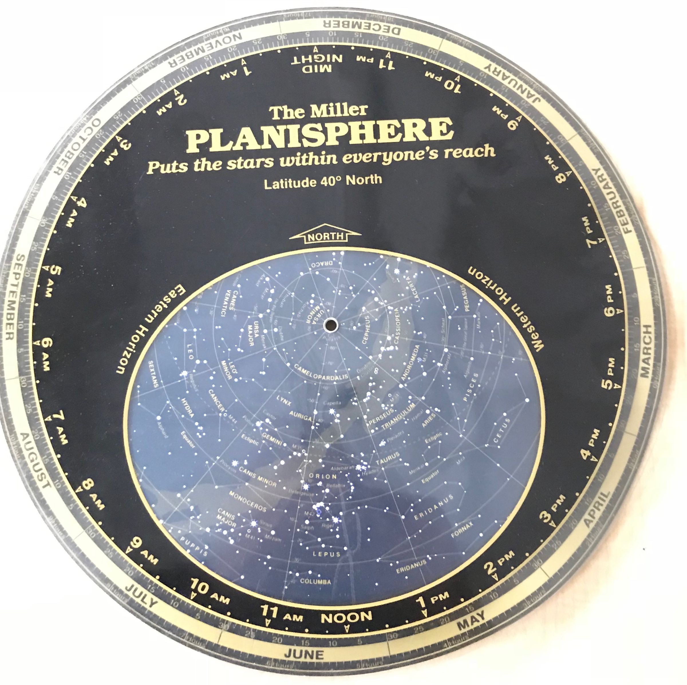

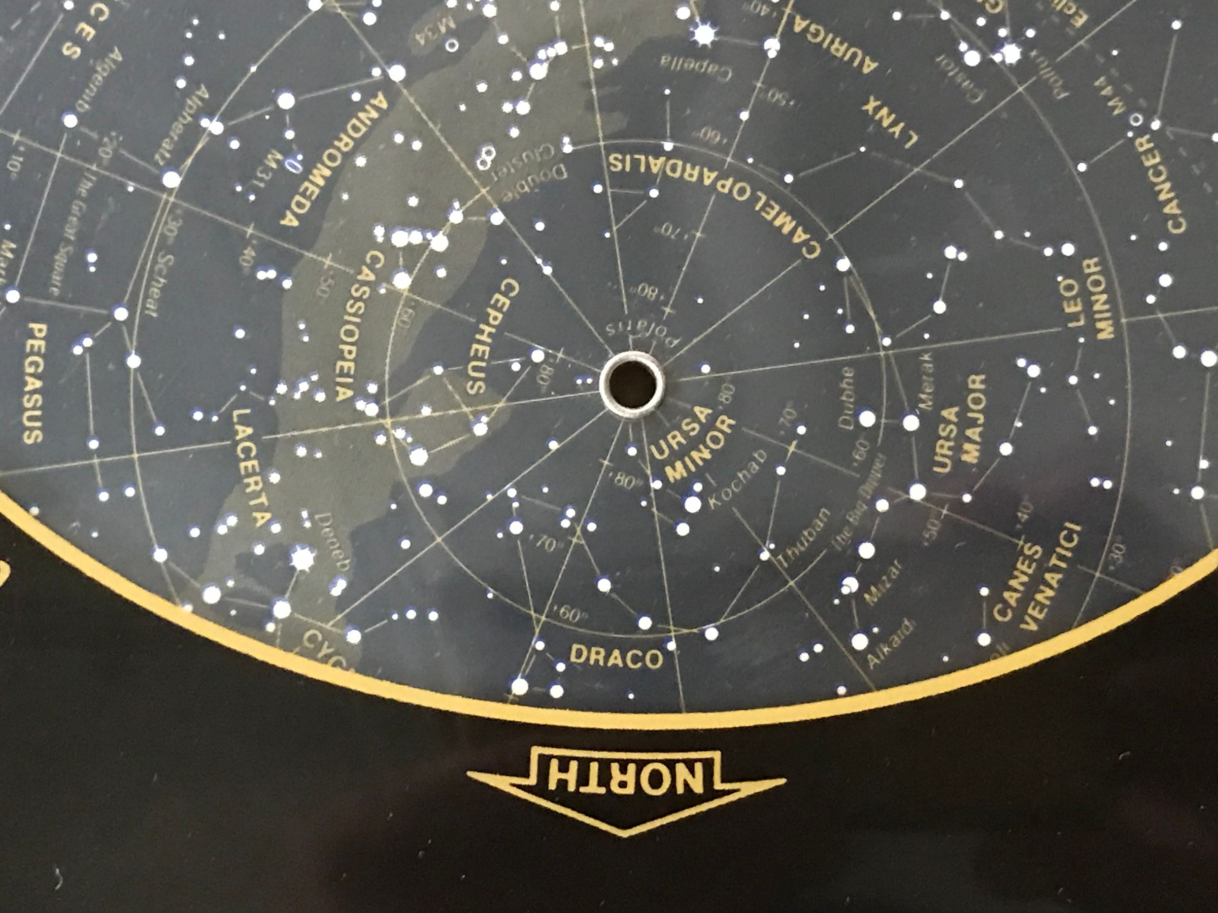

The Planisphere
To understand how the astrolabe works, it is easier to start out with the astrolabe's great grandson - the planisphere. Long before smartphones and computers were used to create digital star maps, this modest device was used by millions of amateur astronomers to identify the stars in the sky. You can still find them for sale, and they are still a great way to learn the names of stars and constellations. If you want to build your own planisphere, there is an Instructable on constructing a Starwheel for Backyard Astronomy that will teach you how.
To use a planisphere, you need to just align your current date in the outer ring to the current time on the inner ring. In the picture, you can see that the device is set for January 13 at 9pm. You can see that the astrolabe is also aligned to work on January 28 at 8pm and February 13 at 7pm.
We normally measure the length of a day by Earth's rotation as measured with respect to the Sun. The Earth, however, orbits around the Sun. Because of this, the rotation of the Earth measured with respect to the stars takes about four minutes less than the rotation of the Earth as measure with respect to the Sun. This means that stars we saw in the sky at 8pm 15 days ago are in the sky at 7pm. The planisphere accounts for this by having both a time and a date ring. By aligning these two rings, you can set the stars to the right position for any time during the year.
The stars that appear in the oval window are the stars that appear in your local sky. If hold put the device above your head, the star positions on the map align with the locations of the stars in the night sky. The edge of the oval window represents your local horizon. The center of the oval window (not the rivet at the center of the planisphere) is the zenith - the point directly above your head. If you want to look at stars near the northern horizon, you need to have the word North pointing towards you like in the diagram below.. In the picture below, you can see Ursa Major (a.k.a. the Big Dipper) is tilted upward just to the east of North.
The rivet that is at the center of the planisphere represents the point directly above the north pole of Earth. This is called the North Celestial Pole. Because of this unique location, stars appear to rotate around it during the night. The star nearest to it is Polaris (a.k.a. The North Star). This star remains fixed directly above due north at all times. If you can find Polaris, you can find North.
Planispheres are usually created for some range of latitudes. The one in this photograph was set for the range between 35 and 45 degrees North Latitude. For getting a general idea of what is in the sky, this kind of accuracy is fine.

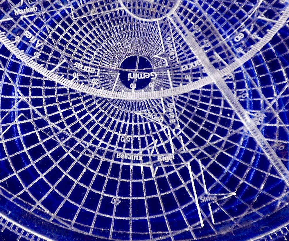

The Astrolabe
The astrolabe works in nearly the same way as the planisphere. Just like the astrolabe, you need to set the time and date to align the positions of the stars. However with the astrolabe we need to take one additional step. Before setting the time, you need to find the location of the Sun in the sky. Here are the steps to align your astrolabe:
  1. Go to the back side of the astrolabe. When you align the alidade to the current date, you can determine where the Sun is in the Zodiac. In the picture below, I aligned the center line of the pointer to January 13. We can see that the Sun is 22 degrees into the constellation of Capricorn.
  2. Flip the astrolabe over and hold it by the crown. Find the circle on the rete that represents the ecliptic. This circle is labeled with constellation names, but also has a degree setting within each constellation. This ecliptic is the annual path of the Sun through the stars during the year. This apparent motion is actually caused by the Earth orbiting the Sun. Up to Copernicus, this motion was understood to be the actual path the Sun travelled in its yearly journey through the background stars.
  3. Align the rule of the astrolabe to the position of the Sun on the ecliptic circle. For our example, I put the rule on 22 degrees in the constellation of Capricorn.
  4. Now move the rule and the rete together so the rule points to the correct time. Noon is at the crown of the astrolabe while midnight is located directly opposite of the crown. The Roman Numerals tell you the time. In our example, I've set the time to 9pm.
Congratulations, your astrolabe is now aligned with the Universe!
Determining positions of the stars.
The underlying grid in the astrolabe allows you to determine the precise location of stars. This grid is very similar to the giant oval window on the planisphere, but it is calibrated with angular markings for your location. The outer level of the grid is the horizon. The center of the grid is the zenith, the point directly above your head.
Just link with the planisphere, the rotation point represents the location of the North Celestial Pole and the star Polaris. Everything rotates around this point because of the daily rotation of the Earth.
If you look near the sharp points in the rete, you can see star names or at least the abbreviations of the stars. In the picture, you can see the point with the letters "Aldeb" next to it. The spike next to "Aldeb" represents the position of the star Aldebaran, the star at the eye of the bull in the constellation of Taurus. Each of the circles in the grid is 5 degrees apart. You can see a scale printed on the grid with the numbers 40 and 60. Those represent the circles of positions 40 and 60 degrees above the horizon respectively. Using this grid we can see that the star Aldebaran is located 10 degrees above the 60 degree circle, or about 70 degrees above the horizon. We can also determine the azimuth or compass heading of objects. North is toward the crown of the astrolabe, east is to the left side, and so on. Because of the type of projection being used, these directions are backwards compared to the Planisphere.
We can also use the back side of the astrolabe to verify the altitude of the astronomy Aldebaran. First, you need to go outside and find the star in the sky. To make the altitude measurements accurately, you need to suspend the astrolabe by its crown on in sure it is being held vertically. The hole in the top of the crown is designed to hold a string, cord, or rope for this purpose. You then use the alidade to site the star and read the angle off of the scale on the back. Since the Sun's path is divided into exactly 12 constellation along the ecliptic (known as the Zodiac) and each constellation spans exactly 30 degrees, you just need to use the outer scale of the device to determine this angle. One of the amazing things about this device is you can work this process backwards and use the position of astronomical objects to determine the time. Instead of knowing what the time is, you can do a sighting of a star to determine its altitude, and then place it in the correct location on the grid. By using the rule, you can figure out what the time is if you know the current date.
Because the astrolabe was originally made of brass, there are only about 20 stars on the rete. If you were an educated 11 year old in the 13th century, your father would make sure you knew the names of these stars and knew how to find them in the night sky. The planisphere does allow you to see more objects, but the grid of the astrolabe and the ability to do sightings make it a more precise instrument for determining time or making astronomical calculations.

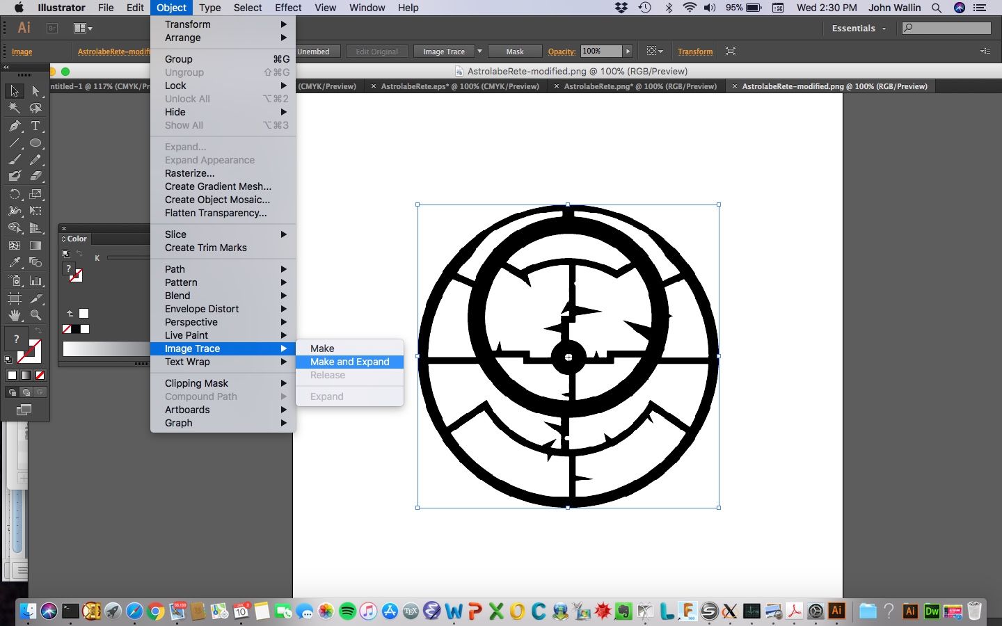

Step 11: Optional Instructions: How to Create the Cutting Template for the Rete
Most people will not need to make a customized rete. The rete I made using the template from Richard Wymarc's software will work for any astrolabe in the Northern Hemisphere. If you live in the southern hemisphere or you want to design your own rete, I thought it would be helpful to detail the steps I used to create it. This same set of steps here can be use to etch around any Adobe Illustrator file. Remember, these are OPTIONAL steps!
Laser cutters can both etch and cut materials. For Epilog laser systems, the software is designed to etch any graphical vector graphical elements with a "hairline" or "0.01 pt" width. Other vector or bitmap elements are etched instead of cut into the material. To make a design that is both etched and cut, you need to separate the outline you want to cut into vector elements with a width of 0.01pt and combine it with the original image.

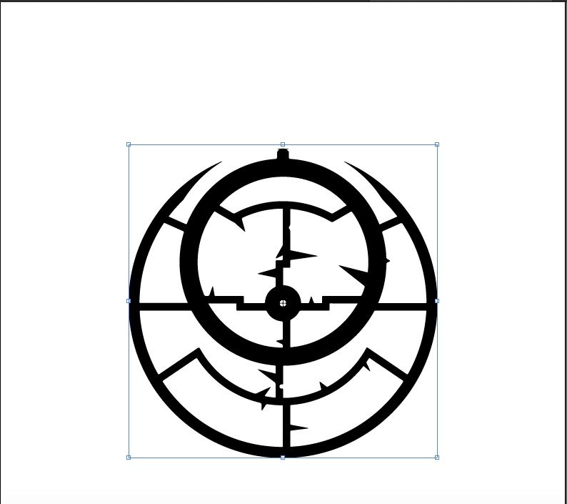

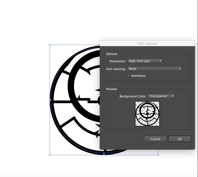

The basic way we make an etching template in Adobe Illustrator for this project is to turn the EPS image into a bitmap. From the bitmap, you can silhouette the image and then modify it so it is a bit stronger in a few select places for when you cut the acrylic. From this modified bitmap, you can trace an outline of the rete. You then combine the rete outline with the original modified eps file so the cutting outline is merged with the etching outline.
  1. Import the EPS file into Adobe Illustrator.
  2. Select everything in the frame, and ungroup them.
  3. Select the outer transparent frame, and delete it.
  4. Select one of the corner registration marks, delete it as well.
  5. Select everything, and then group it.
  6. Export this image as a file named “rete.png”. Keep this at 300 DPI with transparency. To do the image tracing in Illustrator, we need to use a bitmap file rather than a vector file. This step exports the image as a bitmap file.
  7. Open “rete.png” into a new window. This will import the file as a bitmap image rather than a vector image.
  8. From the top menu, select from “Image Trace” the “Silhouette the image” option. This will convert the image into a black outline of the original rete.
  9. Since the top of the rete comes together into sharp points, it helps to strengthen this part of the plastic. Do this by creating a circle of the same size as the astrolabe – I created a circle with 427 pixels x 427 pixels with a size of 9 points in width.
  10. I used the alignment features in Illustrator to make sure it was on-top of the original bitmap file. The image below shows the graphics after horizontal alignment.

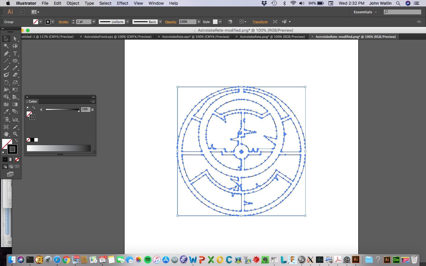

  11. Because this is now an image mixed between vectors and bitmap, you need to export this again as a PNG image. I used the name “rete-modified.png”.
  12. Once again, read the “rete-modified.png” file into Adobe Illustrator.
  13. From the Object menu, select Image Trace -> Expand.
  14. Select the fill of the object, and turn it into empty/null.
  15. Select the outline, turn it to black and then set the width of the lines to 0.01pt.
  16. Select everything, and then group it.
  17. Go back to the original "AstrolabeRete.eps" image. Ungroup everything, and the systematically eliminate any graphical element that is colored grey. Make sure you don't delete the marker lines or labels. Group this when you are done, and copy it into your buffer.
  18. Paste the edited rete back in the frame where you created the outline. Move this image to the back layer.
  19. Align the rete EPS image vertically and horizontally with the outline. You now have a vector image with a width of 0.01 pt for the cutting along with another vector image that will be used for etching.
Of course, you don’t need to do this - that's why I provided the template!
