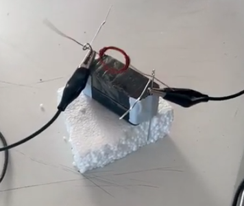

Step 1: Build the Base
Attach the two magnets on top of each other to the styrofoam block. You can use glue or double-sided tape, but there must not be anything on top of the magnet, because it might disrupt the magnetic field.
Step 2: Attach the Paper Clips
attach the paper clips to the side of the magnets with electrical tape. Make sure that the tape is tight because the paperclip might slip. The paper clips are used to move the current through the armature.

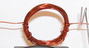

Step 3: Make the Armature
the armature is one of the most important parts of the whole DC motor. When the electrical current is passed through the paper clips and through the armature, the armature will basically become an electromagnet.
To make the armature you wrap the copper wire around your finger until there are about 6 inches of copper wire left on each side. Then, wrap the leftover copper wire around the circle that you just made to secure it. Leave about 1 inch of wire on each side.
Finally, using sand paper, sand off the ends of the copper wire. This is because the wire has a protective coating that might impair the flow of the electricity.
Step 4: Connect the Motor to a Power Supply
Without a power supply, there would be no electricity to power the motor. You can use a D-cell battery, a 9-volt battery, or a larger battery if you wish. Connect the battery to the motor with crocodile clips. Clip the clips onto the bottom of each paper clip. It might be hard to put them on because of the magnet.
Changing the orientation of the battery will also change the direction of the electrical current. If you change the orientation you might get better results with your motor.
Step 5: Make Iterations
Your motor will probably not work the first time, so you will have to constantly fiddle with the armature and the paper clips to make them line up and spin correctly.
Problems that might make your motor not work are:
  • The ends of the armature are not straight so it gets caught on the paper clips
  • the armature is too heavy. If this is the case make a smaller armature with fewer loops and smaller-sized loops.
  • the armature is too far away from the magnet. If you attached the paper clips too far up the magnet, the magnets might not be strong enough to cause the armature to try to align itself with the orientation of the magnet.
  • you might have forgotten to sand down the ends of the armature
  • the battery that you are using might be dead or not strong enough
Step 6: Finally Make the Motor Work
The motor is working when it is spinning constantly for a long amount of time.
