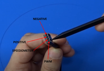

Step 4: 🧠Wire the Voltage Regulator
Trim the fan cable, separating the 4 wires. Use only the black (GND) and red (12V) wires. Solder them to "Motor+" and "Motor-" on the regulator. Connect the DC jack to "Power+" and "Power-". Tighten screws securely.
