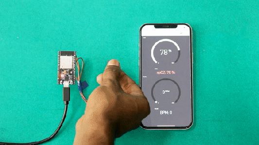

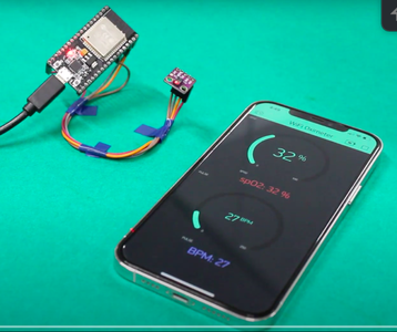

Step 9: Demonstration
Upload the program and you should start seeing values on your Blynk App. Once you attach the sensor to your fingertip, you will start seeing the BPM and SPO2 reading immediately. Notice that the readings update almost instantaneously whenever there’s a change.
