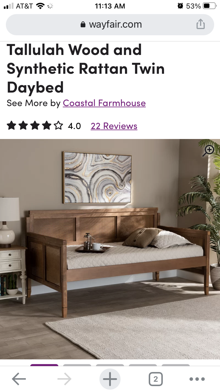

We've been working from home so what use to be a guest room is now an office/classroom. We've also ruined a few couches while at home during quarantine so we started the search for a new one. Hopefully something deep and comfortable to lounge on while watching tv or just taking a nap. My wife found one she liked on Wayfair but it was close to $500. I looked at it and said out loud to no one, "I can build that for $100. It's just 2x2s and 1x6s with a little paneling." I knew there was a left over twin memory foam mattress hanging around so I set out to the local Home Depot with my very detailed plan (pictured). Bought 12 2x2X8s, 6 1x6X8s, some wood glue and 2 1/2 pocket hole screws. I already had on hand saws, drills, clamps, Kreg jig, an orbital sander, a handful of different length screws lay around in a drawer, a sixer of Blue Moon, and a dream. A few hours later I was admiring my work.
