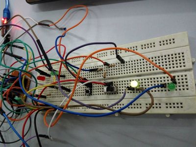

Step 5: Sample Hardware Installation
Set up the all the materials refering to the figure above.
( *Note: The 5V output voltage can kill the ESP8266. So, using the 1Kohms and 2Kohms resistor and connect these two in series with TX pin of the communicator FTDI to 1k resistor and GND to the 2k resistor. The junction between the resistor is connected to the RX of the ESP8266 to get 3.3V signal from the communicator FTDI )

1. led0 is use to indicate the connection of the ESP8266 and the wifi. If the connection between the wifi and ESP8266 lost, the ESP8266 will turn off the led0 on GPIO13. led0 will light up again when the ESP8266 is reconnecting to wifi successfully.
2. ledSensor is the output LED that connect to GPIO16. The ledSensor will light up when the flame is detected by flame sensor module.(I am using flame sensor module in this project, you can use other sensor to replace the variable resistor in the figure above)
3. led1 and led2 is the led that controlled by GPIO4 and GPIO5 respectively through our webserver.

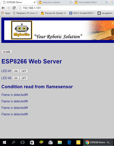

Step 7: Results
The Serial Monitor will print :
Connected to xxxxxxxxxxx
IP address: xxx.xxx.x.x
MDNS responder started
HTTP server started
The IP address shown in the serial monitor screen is the address of your ESP8266 webserver.
led0 which connect to GPIO13 should light up when the ESP8266 is connected to the wifi. Now , you can try to control the led1 and led2 by pressing the ON/OFF button on the webserver and see whether led1 and led2 is light up or not. ledSensor will light up when the flame is detected by flame sensor module.
After the flame is detected , ESP8266 will update and send information " Flame is detected!!! " to the webserver.
