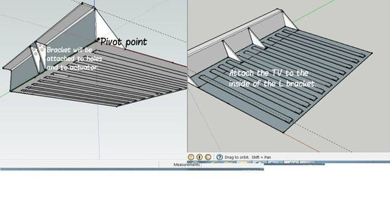

Step 2: Construct a Bracket
To use a linear actuator to make a flip down TV lift you have to create a large L type bracket. The TV will mount on the inside of the large L. The customer had this bracket custom manufactured from this concept drawing. The actuator will be attached at the top on the outside of the L so that as the actuator pushes it rotates the bracket 90 degrees around the fixed pivot point and lowers the TV down.

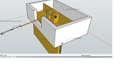

Step 3: Attatch the Actuator Using Brackets
Attach the actuator to the outside of the L bracket at one end and to a joist in the ceiling at the other end. In this application the actuator is fully extended when the TV is in the down position. When the TV is pulled close the actuator is pulling the end of the L bracket back into place and rotating the entire mechanism around the pivot point. The gas spring was used in this instance to assist with the pulling because the closer you are to the pivot point the more force is required. A drywall box was constructed inside the ceiling so that when the TV is in the down position all the electrical and things in the ceiling are hidden.

Here is another drawing to help you envision the concept. Remember that when the TV is fully down the actuator is fully extended. To figure out what stroke size to order (the distance the actuator needs to travel) determine the distance required for the short end of the L bracket to turn 90 degrees. 9" - 12" should be sufficient. We suggest the FA-400-L-12 because these actuators are quiet, high force, have built in limit switches, and are easy to operate. Connect the remote control which will operate the actuator and 12V DC power supply to run it all. Or alternatively have an electrician install a power outlet for you in the ceiling.
