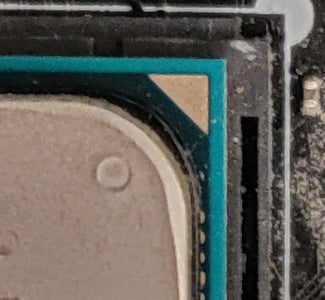

Step 2: Install the CPU
a. Take the motherboard out of its box then take it out of its anti-static bag and place it on top of the box it came in.
b. Locate the CPU slot.
c. Lift up the metal latch on the CPU slot.
d. Unbox CPU.
e. Find the small triangle on the CPU slot and on the CPU.
f. Line up the small triangles and gently place the CPU in its slot.
g. Lastly, push down on the metal latch and lock the CPU in place.

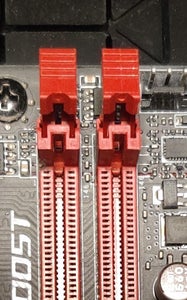

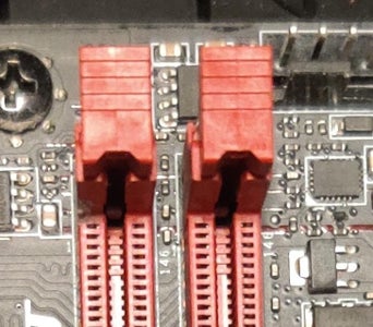

Step 3: Install the Ram
a. Unbox RAM sticks.
b. Locate the RAM slots.
c. Unlatch the latches on RAM slots.
d. Line up the notch in the RAM stick with the notch on the RAM slot.
e. Firmly press RAM stick into place.
f. Repeat steps 3e and 3d for all RAM sticks.

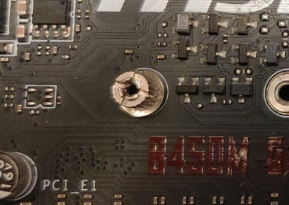

Step 4: Install Storage(M.2)
a. Locate M.2 slot on the motherboard.
b. Remove M.2 cover if needed.
c. Screw-in M.2 standoff.
d. Unbox M.2.
e. Gently push M.2 into the slot.
f. Gently screw M.2 into place.
