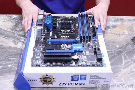

Step 2: Take Motherboard Out of Box
  1. take out the motherboard from its box, and place it right on top of the box. The reason being for doing that is that the back of the motherboard is very easy to break, and having it on top of the box ensures that there is nothing hard or anything to scratch the back.
2.Remove all visual plastic that is around the motherboard. As later on if the computer is running, the plastic can melt onto the motherboard and ruin it.

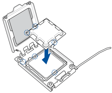

Step 3: Put CPU in Motherboard Slot
  1. When taking out the CPU from its box, please make sure you do not grab the bottom of the CPU. The way to hold your CPU is from its sides, though it is a weird grip, that is the correct way to hold it.
  2. To know which way is the correct way to put down your CPU by the edges and corners. In every CPU, there will be a triangle on the top right corner, and a curve on the top and bottom middle.
  3. The lift opens the CPU slot, there is a lever that must be pushed towards you and pulled upwards. It seems scary when removing it as it requires some force to push down and pull to you, but make sure you keep your finger on the lever, as letting go of it will fling the lever, which could break it.
  4. When removing the cover, line up the CPU with the steps mentioned above, and slowly drop it in.
  5. now the scariest part is closing the cover back with the CPU in. Have no fear, the pressure may seem difficult but it is just like opening the latch as you did before. Simply press your finger down on the lever push until its down to its placeholder, and slide it to its side. Just like that, that's your step one!

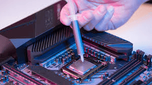

Step 4: ADDING YOUR THERMAL PASTE
  1. inside of the box of your CPU, there should either be a little tube of thermal paste, or a pad of paste that you are able to use. Simply take it out the box and remove the cap or rip an opening.
  2. there are different ways you can apply thermal paste, but the main reminder is to make sure you to do not use the whole thing, as the CPU only needs a small drop.
  3. the ways you can place it on the CPU is making an X shape, putting dots in every corner of the CPU, or putting a bigger dot in the middle.

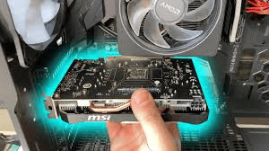

Step 9: Installing the GPU
  1. Installing the GPU is just like installing the ram, with one small difference.
  2. there will be a clip on the far right side of the GPU holder, simply push on it to open up the clip. Once it is open, simply put the GPU into the slot and push on it until you hear a click, that way you know the GPU has been locked and installed.

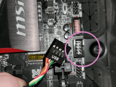

Step 11: Doing the Wiring for the Computer
  1. Now the wiring of the computers seems like the scariest part of the whole build, but in reality it is just all listed for you, and all you do is follow the cords.
  2. As an example, in the case wires, there will be a wire called "USB," and all you need to do is find the spot that says "USB" and put the wire in until you hear a click. and you repeat with every other wire.

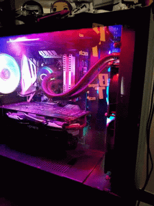

Step 13: Step Back and Give Yourself a Pat on the Back
Step back and look at the creation that you have just made. the lights coming from the computer, everything turned on and working perfectly. Take a good deep breath and clap for yourself, as you just built your very first gaming computer.
