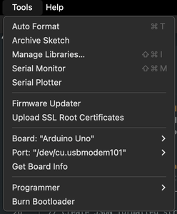

  7. Select the Correct Board and Port:
  8. Open the Arduino IDE.
  9. Go to Tools > Board and select your Arduino model.
  10. Go to Tools > Port and select the port corresponding to your Arduino (e.g., COM3 on Windows or /dev/cu.usbmodem on macOS).

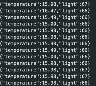

  6. Test Serial Output:
  7. Open the Serial Monitor from Tools > Serial Monitor.
  8. You should see temperature and light intensity readings in JSON format.
