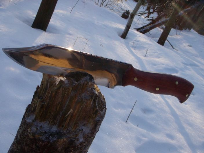

Step 9: Finished! and Some of the Mistakes I Made Along the Way.
Well, there you go. A finished knife. I'm happy with the way it came out--yet I'm not immune from mistakes. Picture two shows my most egregious error--when I drilled the holes through the first handle slab I hadn't let the epoxy set fully, and the slab slipped before I drilled without me noticing it. It was only after I drilled three of the holes that I realized that the wood wasn't covering part of the handle. Fortunately I one of those holes was in the right place, and I was able to gently move the wood back into the right position before it dried. I continued along with the project and disguised the holes with two plugs of Purpleheart wood. Since I took the picture the wood has darkened and the plugs have become a little more blended with the handle. I kind of like them--they add a little character to the blade.
The third picture is hard to see, but it shows a hairline fracture on the spine of the knife. At first I thought it was just a tough scratch from when I did the filework, but I realized later that it was on both sides of the blade. It's small and I don't think it really compromises the blade's strength, as it only extends about three eighths of an inch in.
I guess this section is just here to let you know that we all make mistakes, and you shouldn't punish yourself for making them. Building a fine knife is something to be very proud of, and a few mistakes make it no less amazing.
