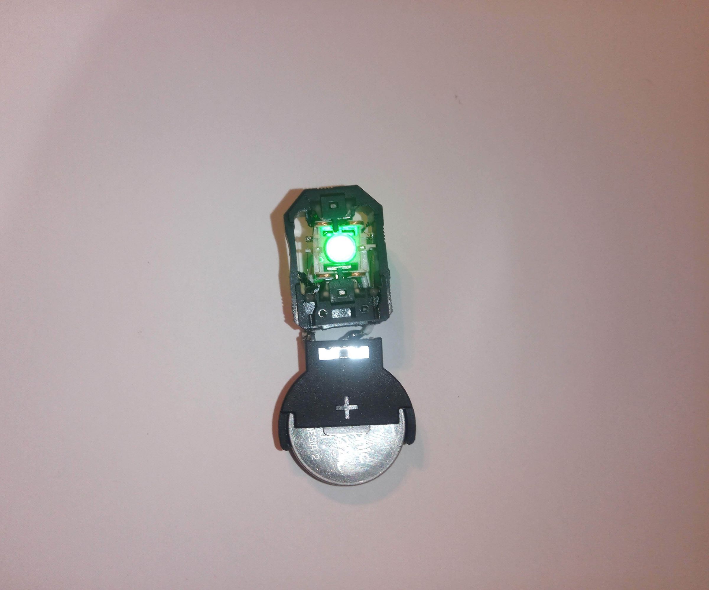

Step 11: Add the LED
Insert the LED into the hole drilled in the front of the brick.
With the LED inserted in the hole, bend the leads as shown in the picture. One lead should be bent to meet with one of the pins of the pushbutton (the one closest to the LED) as shown in the picture. Use wire cutters to clip the lead to meet the pushbutton lead and carefully solder them together.
The other LED lead should extend over the pushbutton and into the battery compartment. Make sure it doesn't contact the other lead of the LED or the other leg of the pushbutton.
Note that, if the legs of your LED are too short, you can use the wire to cover the distance between the LED's bottom lead and the pushbutton, and to extend the top lead into the battery compartment. The second picture above shows how I did this with another flashlight block I made.
Glue the LED into the hole in the front of the brick. If you did not use a 5mm drill bit, you may need to center the LED in the hole and hold it in place for a minute or two while the glue dries.

If the LED doesn't turn on, reverse the batteries and try again.
If the LED still won't turn on, you may need to check your solder connections and make sure that the wires contacting each end of the battery stack are making good connections.
