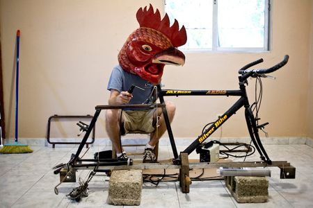

Step 4: Build a Jig
I'm using the term "jig" very loosely. We found a piece of aluminium U-channel that was long enough and attached the frame to it in order to hold the frame in a straight line.
Step 5: Wire It Up
We used bailing wire to hold everything in place. Clamps would work better.
Step 6: Measure
We used string and a ruler and a nail on the end of the string to build a plumb-bob. The goal is keep everything as straight as possible.

Step 8: Find a Welder
We used this cheap stick welder and used 50-75 amps for all of the welding.
Step 9: Weld
tack weld then measure/eyeball everything for alignment and weld some more.
