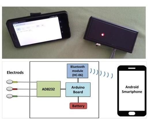

Please see my new Instructable for a cheaper and easier to build (less than 1 hour) ECG device. Also the Android App has been updated with further features and tested on on Android 6, 7, 8 and 10 mobiles. Its cost is between 20 and 25 Euros (25-30 US dollars).

An easier and newer device version is available on another Instructable of mine: the device is based on the off-the-shelf AD8232 module (no need to build the electronic board) and can be built in less than 1 hour! You can find also a newer Android App (version 4.4) tested on Android 6, 7, 8 and 10 mobiles.

Step 4: Description
The device is battery powered and consists of a front-end circuit to acquire the ECG signals (limb leads only) through common electrodes and an Arduino board to digitalize the analog signal and transmit it to an Android smartphone via Bluetooth protocol. The related App visualizes the ECG signal in real time and gives the possibility to filter and store the signal in a file.

Step 6: HARDWARE DESCRIPTION
The simple circuit design and layout are a good compromise for having both a low cost (few components) and good performance.
The battery supplies (+Vb) the Arduino board and the led L1 when the device is turned on (R12 = 10 kOhm controls L1 current); the rest of the device is supplied by the Arduino 5 V voltage output (+Vcc). Basically the device works between 0 V (-Vcc) and 5 V (+Vcc), however the single supply is converted to dual supply by a voltage divider with equal resistors (R10 and R11 = 1 MOhm), followed by a unity gain buffer (1/2 TL062). The output has 2.5 V (the mid-voltage of the TL062 power supply: 0-5 V); the positive and the negative rails of power then give a dual supply (± 2.5 V) with respect to the common terminal (reference value). The capacitors C3 (100 nF), C4 (100 nF), C5 (1 uF, electrolytic) and C6 (1 uF, electrolytic) make the voltage supply more stable. For safety issue, each electrode is connected to the device through a protection resistor of 560 kOhm (R3, R4, R13) to limit the current flowing into the patient in case of a fault inside the device. These high resistors (R3, R4, R13) should be used against the rare situation when the low voltage power (6 or 9 V, according to the used battery supply voltage) comes directly to the patient leads accidentally, or due to the INA component failing. Besides, two CR high pass filters (C1-R1 and C2-R2), placed at two inputs, block the dc current and reduce unwanted dc and low-frequency noise generated by contact potentials of electrodes. ECG signal is so high pass filtered before the amplifying stage with a cut off frequency around 0.1 Hz (at -3 dB). The presence of R1 (as R2) reduces the input impendence of the pre-amplification stage so that the signal is reduced by a factor depending on the value of the R1 and R3 (as R2 and R4); such factor can be approximated as:
R1 / (R1 + R3) = 0.797 if R1 = 2.2 MOhm and R2 = 560 kOhm
It is more advisable to choose the couple C1 - C2 (1 uF, film capacitor) with capacity values very close each other, the couple R1- R2 (2.2 MOhm) with resistance values very close each other and the same for the couple R3 - R4. In this way, an unwanted offset is reduced and not amplified by the instrumentation amplifier (INA128). Any mismatch between circuit parameters of the components in the dual input circuit contributes to a degradation of the CMRR; such components should be very well matched (even the physical layout) so that their tolerance should be chosen as low as possible (alternatively the operator can measure their values manually with a multimeter in order to choose the couple components with the values as close as possible). R5 (2.2 kOhm) defines the INA128 gain according to the formula:
G_INA = 1 + (50 kΩ / R5)
ECG signal is so amplified by the INA and successively high pass filtered by C7 and R7 (with a -3 dB cut off frequency around 0.1 Hz if C7 = 1 uF and R7 = 2.2 MOhm) to eliminate any dc offset voltage before the last and higher amplification made by the operation amplifier (1/2 TL062) in a non-inverting configuration with a gain:
G_TL062 = 1 + (R8 / (Rp+R6))
To let the user change the gain at runtime, the operator can choose to use a variable resistor (trimmer / potentiometer) instead of Rp or a female socket strip for a resistor that can be changeable (because not soldered). However, in the first case it is not possible to know exactly the actually gain of the ECG signal (the values in mV of the data will be not correct) while in the second case it is possible to have the correct values in mV by specifying the value of Rp in the formula “Gain” inside the “Setting” section of the app (see User Manual). C8 capacitor creates a low pass filter with a -3 dB cut off frequency around 40 Hz as the RC filter composed by R9 and C9. The cut-off frequency value is given by the formula:
f= 1 / (2*π*C*R).
For low pass filters @ 40 Hz [1], RC components values are:
R8 = 120 kOhm , C8 = 33 nF , R9 = 39 kOhm , C9 = 100 nF
The ECG signal is so filtered in a band between 0.1 and 40 Hz and amplified with a gain equal to:
Gain = 0.797 * G_INA * G_TL062
Since R5 = 2,2 kOhm , R8=120 kOhm, R6=100 Ohm, Rp=2,2 KOhm ,
Gain = 0.797 * (1+50000 / 2200) * (1+120000 / (2200 + 100)) = 1005
To have accurate values for the filter cut-off frequencies, RC filter components should have a tolerance as low as possible (alternatively the operator can measure their values manually with a multimeter in order to choose the ones closest to the desired value).
The analog signal is digitalized by the Arduino board (A0 input channel) and then transmitted to the HC-06 module by the serial communication pins; finally, the data are sent to the smartphone by Bluetooth.
The reference electrode (black) is optional and can be excluded by removing the jumper J1 (or the operator can use a switch instead of the jumper). The circuit configuration is designed to work also with two electrodes; however, the reference electrode should be used to have a better signal quality (lower noise).
