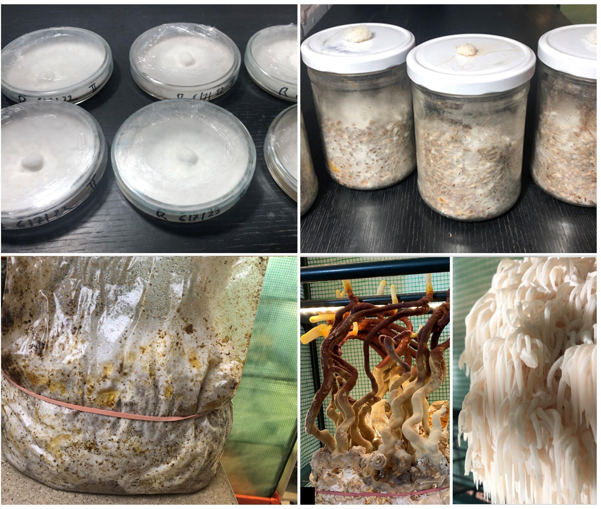

You want how to perform cloning and work your way up from agar to grain to sawdust spawn?
In my Playlist you will finde everything about building a Martha grow tent, and also about processing the Mushrooms.
