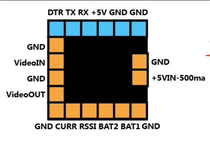

  6. Solder the +5V, GND, Tx and Rx pads of the Micro MinimOSD to the Piko BLX using short lengths of wire. This allows the flight controller to send the battery voltage and RSSI data to the OSD. You can find the exact wiring diagram here.
  7. Mount the Micro MinimOSD in the small space under the Piko BLX mounting area. Solder the video input wire from the camera and output wire to the VTx. I have attached the OSD pinout to this step.

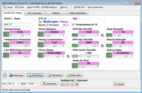

I first flashed the Piko BLX with the latest version of Betaflight (3.0 RC12 at the time of writing). It is still in pre-release and may be buggy. If you want more stable firmware, you can find older releases of Betaflight and Cleanflight on the FuriousFPV website. I also flashed the ESCs to the latest version of BLHeli_S (16.3 at the time of writing) using the passthrough function on the flight controller and the BLHeliSuite software. This requires you to plug in the battery, so make sure the propellors are off and there are no shorts/ solder blobs (double check with a multimeter and use a SmokeStopper when you plug in the battery for the first time).
I then calibrated the ESCs from the Betaflight configurator software. I have attached pictures which show my current settings in both Betaflight and BLHeliSuite.
