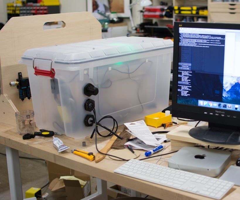

In order to characterize the response of a laser particle counter, we need to introduce particles of known sizes into a test chamber. By comparing the voltage response (scattered light intensity) of the sensor’s analog circuitry between particles of various known sizes, we can pick voltage cutoffs for approximately sorting particles measured in the real world by size. (A limitation of optical particle counting is that the amount of light scattered depends not only on the size of the particle, but on the composition, shape, color, and where the particle strikes the laser beam. This is true for the MyPart sensor as well.)
Commercial atomizers are capable of producing droplets of precise and controllable sizes from a variety of fluids (oil, saltwater, etc). However, these instruments typically cost thousands of dollars.
A cheaper alternative for precisely controlling the size of the droplets atomized is buying calibration particles that are manufactured to a particular size. Less expensive atomizers can then be used to generate droplets of a larger distribution of sizes. However, when the droplets dry, we are left with the calibration particles in their nominal diameter.
In our system, we disperse Polystyrene Latex (PSL) beads of 0.5um and 3.0um diameters using an off the shelf medical nebulizer. Clean air is provided by passing compressed air through a series of filters. The humidity of the chamber is controlled with desiccant inside the chamber.
The following instructions are for our particular setup, but can be easily adapted for your particular application (additional valves, filters, particles, etc).

Step 1: High Level Description
In our system, particles of known sizes are generated through the following steps:
  1. Pressurized air comes in from a compressor.
  2. The air passes through a two stage filter and regulator. The air is now clean and free from ambient particles of unknown sizes.
  3. The test chamber is purged using the clean air from step 2.
  4. Once the chamber is clean (sensors read ~0), the clean air is used for the nebulizer to atomize an aqueous solution containing PSL beads of a single size. The droplets that are generated from the atomizer are a mixture of pure water and PSL bead covered in water.
  5. The air/water/PSL bead mixture is injected into the chamber, where the water evaporates in the low humidity environment.
  6. When the water evaporates, only the dried PSL beads of the original diameter remain.

Step 3: Assembly: Preparing the Pneumatics
Connect the compressed air filter and regulator. The order is:
(push to connect barbed) -> (2 stage filter) -> (pipe nipple) -> (pressure regulator) -> (1/4in ID barbed fitting)
1/4in NPT threads should go in a maximum of 0.4 inches. (link) The barbed fitting at the output will supply clean air either directly to the chamber, or to the nebulizer. Additional filters can be placed between the pressure regulator and the 2 stage filter.
Connect tubing to the nebulizer so that the atomized droplets can flow into the chamber. The order is:
(nebulizer) -> (¾ in ID tube) -> (¾ in ID tube to 1/2in ID tube barbed adapter) -> (½ in ID tube)
A small pipe clamp is used to attach the 3/4in ID tube to the nebulizer. I forgot to order the 3/4in to 1/2in ID adapter, and machined a quick adapter from 3/4in Delrin that is attached with another pipe clamp.
The only reason we go from a 3/4in tube to a 1/2in tube is to have a more flexible tube that can be routed more easily. If this is not necessary for your setup, you can go directly from the 3/4in tube to an appropriate bulkhead fitting on the chamber. If you want to reduce the tube diameter even further, beware that the water may begin to condense (we initially tried to reduce down to a 1/4in tube and experienced issues with water condensing and clogging the line).

We need inlets on the chamber to allow air (either nebulized PSL or clean air) to be injected.
First, drill two holes into the chamber, sized for the bulkhead fittings. Attach the bulkhead fittings to the chamber with the barbed end facing outward. We positioned the holes in the center of a long edge, below the fans and desiccant tray, so that it would not be blowing directly onto any of our sensors. Orings of the appropriate diameter can be added for better sealing.
To cover these bulkheads when not in use, we made plugs by cutting a small length of the tubing (~2" long) and filling half of them with silicone caulk. The silicone does not bond particularly well to the tubing, but seemed to be sufficient with the low pressure levels in the chamber. Alternatively, real tubing plugs can be purchased.
Note: the tubing is quite hard to remove from these particular bulkhead connector if pushed too far.

Step 8: Running Tests: Execution
Follow the directions in How to Build a Test Chamber for Air Particle Sensors Instructable to run the automated test. While the test is running, you can clean the chamber with compressed air, inject nebulized water, or inject nebulized particles.
Our basic test followed this pattern:
  1. Begin automated testing script.
  2. Purge chamber using filtered compressed air, until sensors read near 0 particles and stabilize.
  3. Close regulator; remove tube from regulator to chamber; plug the open bulkhead fitting.
  4. Attach tube between regulator output and nebulizer; attach nebulizer output to bulkhead fitting.
  5. Open regulator and run until nebulizer is empty. 2ml of liquid takes about 4 minutes to process at 10 PSI.
  6. Turn off regulator and allow the particle concentration to decay naturally in the chamber
  7. Reattach the regulator to the chamber; plug nebulizer bulkhead fitting.
  8. Run filtered compressed air until the chamber is once again clean.
  9. End automated test, or repeat 3-8 with another particle size.
