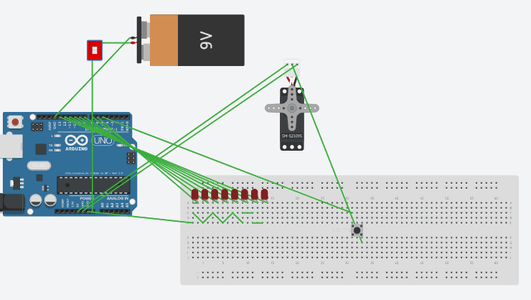

The design plan for this project is very light. It is simply a cylinder with two lids, one on the top and the bottom. One of the lids will be glued in place while the other will move via a servo. There will also be eight LEDs on one side of the cylinder that will light up. The circuitry for the LEDs and servo is very simple. The anode (+) of each LED will be connected to a signal port on an Arduino. The cathode (-) of all the LEDs will be connected with wires. Another wire connected to the cathode of any led will lead to the ground port on the Arduino. For the servo, there will be a wire connecting the Servo to the 5V power port on the Arduino, another wire connecting the servo to the ground port on the Arduino, and another wire connecting the Arduino to the appropriate signal port on the Arduino. We are planning to have the LED's fill up, the higher the energy level in the canister. We will also install a moving lid, to go inside and will look cool.

The circuit for this project is very simple. All you have to do for the LEDs is plug the anode of the LED into an Arduino signal port(You'll Know where to put it based on the code). Then, connect all the cathodes of all the LEDs together. You can do this part on the breadboard. Then connect a wire from the cathode of any LED to the ground port of the Arduino. This wire should connect all the cathodes of the LED to the ground port on the Arduino. For the servo, the brown wire will lead to the ground port, the red one will lead to the 5V power port, and the orange one will be connected to signal port 5 on the Arduino.

There are two switches that need to be added. One for main power, and another for the lid. The main power switch will be a Single Pull Single Throw(SPST) switch, while the lid switch will be a push button switch. Cut holes that match the size of the switches on the back of the cylinder with an X-Acto knife. If necessary, you can cover the edges of the holes with duct tape and paint the tape yellow. Put these switches on the back of the prop so they do not change the look of the prop. In the picture, to the right of the servo, you can see the SPST switch.
Step 13: Solder the Circuit
In this step, you will transfer your circuit from the breadboard to the prop. Currently, the only thing on the breadboard should be the wires connecting the cathodes of the LEDs. Instead of the breadboard, just solder all the negative ends of the LED's together and have one extra wire connected to the cathode of the last LED. So what you will end up having is all the cathodes of the LEDs connected, with one extra wire connected to the negative prong of the last led. That extra wire will connect to the ground part on the Arduino. Also, you will need to solder the battery connector wires in. To do this, connect the positive end of the battery connector to one prong on the main power switch. Also, connect another wire to the other prong on the switch. On the push button, solder two wires, one on each prong.

Connect all the wires to the Arduino. Attach all the LEDs to their respective ports on the Arduino and attach the empty wire from the SPST switch to the VIN port on the Arduino. connect the anode from the battery connector to any ground part on the Arduino. Also, attach one wire from the lid switch to its respective port on the Arduino, and the other to the orange port on the servo. Then test the switches and everything should work.
