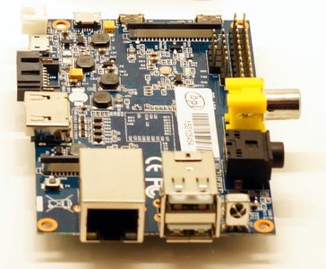

Heart of the NAS
The first thought was to take a RaspberryPi - it is cheap and has low power consumption. But it only has USB to connect a HDD. Into the bargain it shares its 100Mbit bus with the USB. So reading/writing content to HDD and network traffic uses one bus.
Later I find the specs of BananaPi and it was exactly i was looking for:
  • Gigabit LAN
  • SATA 2.0 Port
  • cheap (about 35 Euros)
  • low power consumption
  • small size (like RaspberryPi)

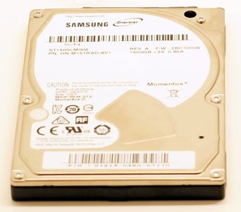

The storage
For storage I decided to take a normal 2,5" notebook drive. I took a Samsung ST15000LM006 with 1,5TB of storage.

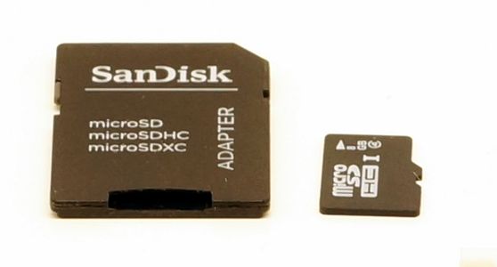

To run the BananaPi there is also a SD-Card necessary. I took an available class 4 card I had on stock, but it is possible to take even better cards; the more faster it is, it is much more better.
To power the whole thing up a 5V/2A Power supply with micro USB connection is needed.

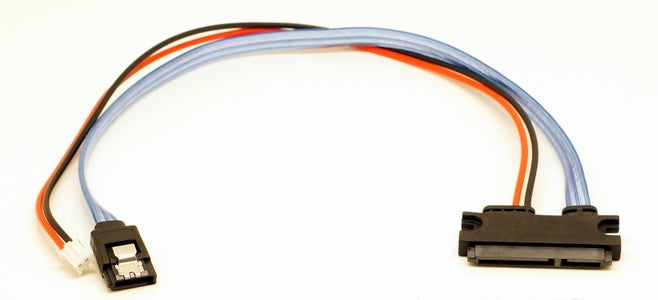

The last part you need to build the NAS is a BananaPi-SATA-cable, like many electronic shops offer it.
