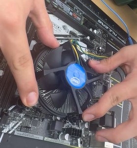

Step 4: Install CPU Cooler
  1. Grab your CPU cooler and thermal paste, put a pea-sized dot on the CPU, and align the CPU cooler.
  2. Once ready put the CPU cooler down push down the 4 plastic pins at the 4 corners of the cooler and then twist the point of the arrow to lock.
  3. Check the bottom of the motherboard to make sure it is pushed through and locked.

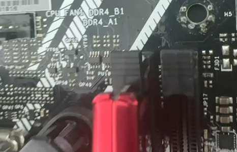

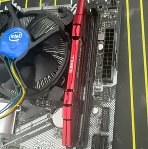

Step 6: Put RAM in Motherboard
keep the case to the side then take RAM and find RAM slots, unclip slots and push ram in until you hear a click.

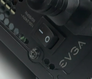

Step 7: Install PSU (Power Supply)
Push the case back up and place the power supply in its designated spot, making sure its connections on the back of the supply are aligned with the back of the case.
Use provided screws to secure the PSU to the case.

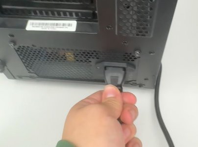

Step 10: Power on PC
Grab a power cable for the PC and monitor, and a display cable (VGA, DVI, HDMI, DisplayPort) that works with your monitor, hook everything up and turn on the PC. (Make sure the power supply is on).
If everything works, congrats! You built your first PC!
