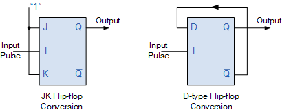

Step 1: T Flip Flop
image sourced from: https://www.electronics-tutorials.ws/sequential/conversion-of-flip-flops.html
The T stands for toggle. If the existing output is 0, the T flip flop turns it to a 1. If the existing output is 1, T flip flop turns to a 0.
You can use a JK flip flop as a T flip flop, by setting both J and K inputs as 1 (as shown in the diagram above). To learn about JK flip flop, go to Step 2 below.
You can also use a D flip flop as a T flip flop by feeding not Q output into D input (as shown in the diagram above). To learn about this, go to https://www.electronics-tutorials.ws/sequential/conversion-of-flip-flops.html.
