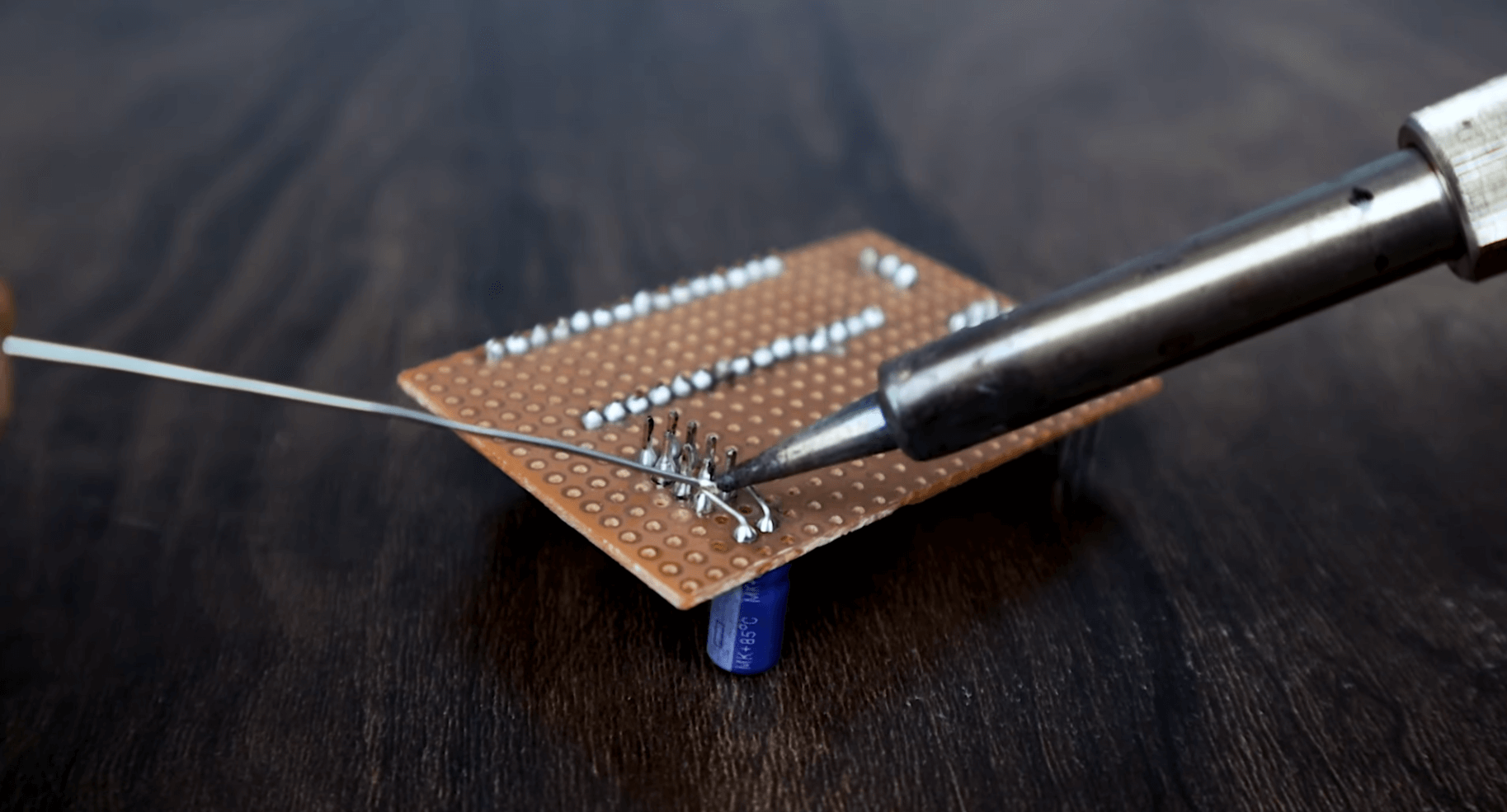

Step 5: Solder the Electronics
Start by installing the switches into the top portion of the case you printed, and then tin each switch’s electrical contacts. Solder a single short wire to each switch leg. We used one red wire and one black wire per switch, so the connections are easy to identify.
Disclaimer: If you’re not comfortable using a soldering iron or working with small electronics, you may want someone to help with this project. Soldering irons can reach temps of around 850 degrees Farenheit (450 degress Celsius), and misusing one can cause serious injury. Please be careful, and remember that you are responsible for your safety.
  • Next, you’ll need to connect the switches in series. To do this, take the black wire from the upper left switch, trim it to length, and solder it to the second switch’s black wire location. Repeat this process with every switch until there is a single black wire connection running between the switches. When you’ve finished, you should also have one long black lead and nine red ones.
  • Now, you’ll connect the Raspberry Pi Pico to the switches using the GPIO pins. Solder the red lead from each switch to a single GPIO pin on the Pi. Use the following pins and their corresponding switch locations as listed:
  • Now, connect the remaining black lead from the last switch to GPIO36. This pin is your 3.3V out and will power the unit when the micro-USB cable is connected. Again, ensure that you use the 3.3V out—and not the 3.3V EN.
