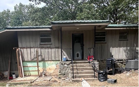

Step 2: Demolition
Tear away any existing structures and clear all debris from your building site.

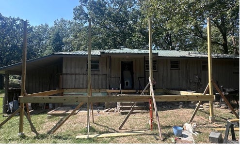

Step 3: Concrete Piers
Measure placement for foundational piers and ensure your foundation is square.
Dig holes 18-24 inches deep and fill with concrete.
Step 4: Erect Posts
Attach a mounting bracket to the top of the concrete pillars.
Stand posts vertically and mount to brackets. Use a level to ensure posts are straight.
Step 5: Deck Framing
Mount Ledger board to existing structure with lag bolts to ensure stability.
Mount beams to the outside of posts and the ledger board on both sides.
Mount joists between the ledger board and beams.

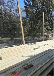

Step 6: Decking
Run decking perpendicular across the top of the joists tightly with little to no gaps.
