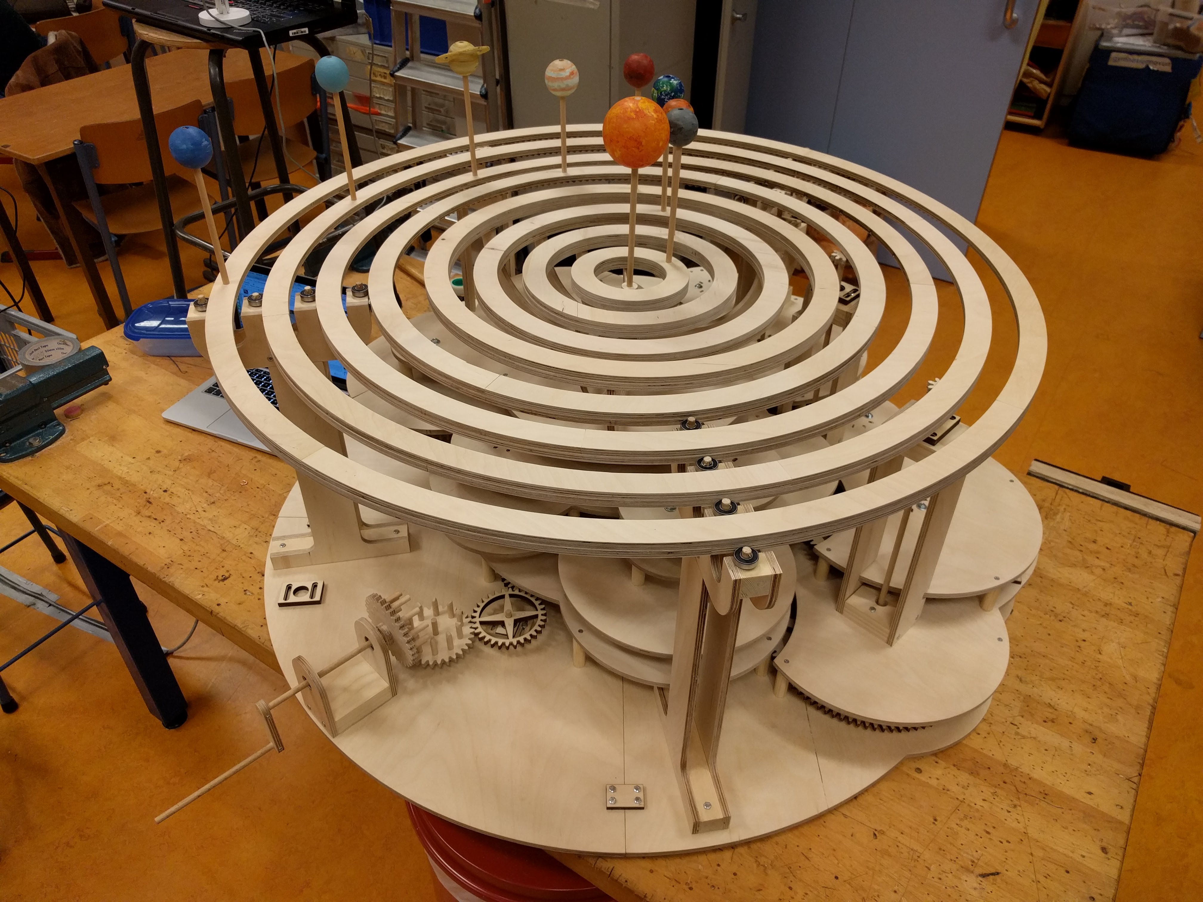

Step 18: Final Result
After hours upon hours of designing, drawing, CNC-milling, sanding, testing and redesigning, I could finally say that this project was finished. Over half a year earlier I had set myself two goals. The first one was to design and build this planetarium all by myself to test my abilities and see if I would be capable of doing this. And half a year later, there I was, with a fully functional mechanical planetarium built and designed all by myself. The second goal I had set myself, was to show the difference in circulation time of the planets around the sun, and to do this as precisely as possible. I had found the following rotation speeds of the eight planets:
- Mercury: 87,969 days
- Venus: 224,701 days
- Earth: 365,256363004 days
- Mars: 686,971 days
- Jupiter: 4.331,59 days
- Saturn: 10.759,22 days
- Uranus: 30.688,5 days
- Neptune: 60.182 days
With the gear combinations I used in my planetarium, I was able to give the planets the following rotation speeds:
- Venus: 224,701002 days
- Earth: 365,256362 days
- Mars: 686,971017 days
- Jupiter: 4.331,58954 days
- Saturn: 10.759,2037 days
- Uranus: 30.688,4161 days
- Neptune: 60.182,6613 days
As you can see, all of the planets in my planetarium rotate at a speed that is nearly the exact same speed as the planets in real life. So I succeeded to give the planets a really precisely accurate rotation speed.
