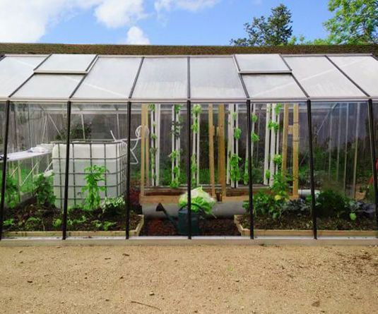

Step 2: Plan Your Final Greenhouse Layout
We recommend that you use half of your greenhouse space for permaculture beds. The way you arrange these will affect the final placement of your aquaponic system if you intend to install one (see electronics tutorial in our instructables list).
Step 3: Prepare the Space
The get the area ready for permaculture beds you have 2 options, you could:
- Dig trenches for your raised beds that are about 30 cm deep
or
- Build simple wood frames out of wood planks if you cannot dig into your ground. (What is pictured here)
The measurements of your wood frames or trenches can vary according to the floor plan you envision for your permaculture garden. We recommend that you use approx. half the space of your future greenhouse for permaculture beds.
