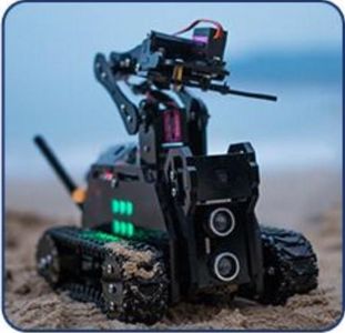

So a couple of years ago I decided to build a robot. After a bit of research, I decided I would use the Raspberry Pi 4, and a motor controller. Thus the era of errors was started in my life. In my defense, I was a beginner, and I was working with some faulty hardware at first. Eventually, I finished it, complete with Bluetooth controllability, live webcam feed, and underpowered motors that didn't even turn on hardwood floors. But to the point, the robot. I have had my eye on this robot for a while, being so cheap and all. You can find it on amazon here and check it out for yourself. The build went surprisingly well, and the end product was well worth the 90$ I payed for it. It is controlled by wifi, has a pi camera for live feed, and even has a gripper claw. So let's get started, and please like and vote for this instructable as I am entering the First Time Author Contest. Enjoy!

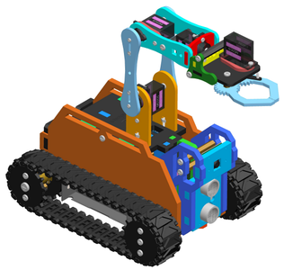

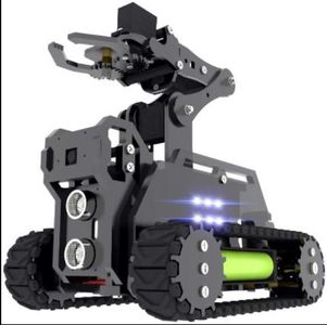

Now the most exciting part, assembly! Follow the assembly precautions here before you get too deep into the hardware though. Now we begin to assemble the robot. This starts here. I am not going to paraphrase the entire assembly instructions, as that would be time-consuming and kind of pointless. My instructions are to just pay close attention and follow everything exactly. As you will notice, the body of the robot is beautiful clear and dark acrylic. It is papered so you need to peel that off before assembly.
About right away you may run into a problem. I believe this will only happen to pi 4 users. When you put the piece of acrylic between the pi and the motor hat, you need to screw some copper standoffs on the top. For me they did not screw on, the lower standoffs were simply too short. My solution was to drill the plastic piece down with a bigger diameter drill bit. This opened it up so the lower standoff could fit deeper. According to other amazon buyers, they sanded it down with a file. Whatever the case it is fairly easy to alter it to fit.
Make sure you follow the directions to debug the servo.

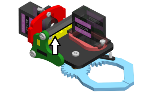

All I can say from here on is that just be careful. There were a few times when I had to push pretty hard to make a bolt go far enough to screw onto the nut, but I managed. Also, I wasn't quite sure about the gripper assembly at one point. As you can see in the diagram above, the black plastic tube is supposed to go on. However, it seemed mine was too long. If I put it on, it would loosen the assembly and look kind of weird, because one side is longer than the other. Eventually, I just put it on.
The other problem I had and still have is the tracks. On one side the wheel does not match up very well to the track. I loosened both sides and that helps the track rotate freely. But now when I'm driving for a while it will loosen way up and almost come off. Maybe I could design and 3d print one and see if that would work better. That's about all the problems I've had, and it turned out pretty nice.

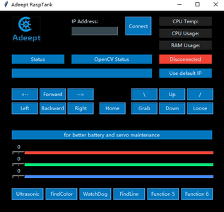

Another method of controlling the robot is by GUI. This is only the compatible with the Windows operating system. You can find the instructions here. You will need to install some libraries first.

I am really impressed with this robot. It has worked very well and the pi camera is fairly good quality. I did notice a crack in one of the plastic arms, and the other side did break(see the pictures above). Thankfully there was a replacement and I could swap it out fairly quickly. I guess the lesson there is to not overtighten the pieces. Anyways, this robot has been a fun build and has taught me a little more about Python and robotics. Thanks for reading!
