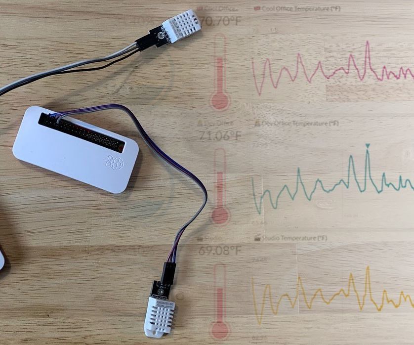

Introduction: How to Build a Raspberry Pi Temperature Monitor
Temperature and humidity are vital data points in today’s industrial world. Monitoring environmental data for server rooms, commercial freezers, and production lines is necessary to keep things running smoothly. There are lots of solutions out there ranging from basic to complex and it can seem overwhelming on what your business needs and where to start.
We’ll walk through how to monitor temperature with a Raspberry Pi and different temperature sensors you can use. This is a good place to start since these solutions are inexpensive, easy to do, and gives you a foundation to build off of for other environmental monitoring.

Step 5: DHT22 Solution
The DHT22 will have three pins — 5V, Gnd, and data. There should be a pin label for power on the DHT22 (e.g. ‘+’ or ‘5V’). Connect this to pin 2 (the top right pin, 5V) of the Pi. The Gnd pin will be labeled ‘-’ or ‘Gnd’ or something equivalent. Connect this to pin 6 Gnd (two pins below the 5V pin) on the Pi. The remaining pin on the DHT22 is the data pin and will be labeled ‘out’ or ‘s’ or ‘data’. Connect this to one of the GPIO pins on the Pi such as GPIO4 (pin 7). Once this is wired, power on your Pi.
Install the Adafruit DHT Python module at a command prompt to make reading DHT22 sensor data super easy:
$ sudo pip install Adafruit_DHT
With our operating system installed along with our two Python modules for reading sensor data and sending data to Initial State, we are ready to write our Python script. The following script will create/append to an Initial State data bucket, read the DHT22 sensor data, and send that data to a real-time dashboard. All you need to do is modify lines 6–11.
import Adafruit_DHT from ISStreamer.Streamer import Streamer import time<br># --------- User Settings --------- SENSOR_LOCATION_NAME = "Office" BUCKET_NAME = ":partly_sunny: Room Temperatures" BUCKET_KEY = "rt0129" ACCESS_KEY = "PLACE YOUR INITIAL STATE ACCESS KEY HERE" MINUTES_BETWEEN_READS = 10METRIC_UNITS = False # --------------------------------- streamer = Streamer(bucket_name=BUCKET_NAME, bucket_key=BUCKET_KEY, access_key=ACCESS_KEY) while True: humidity, temp_c = Adafruit_DHT.read_retry(Adafruit_DHT.DHT22, 4) if METRIC_UNITS: streamer.log(SENSOR_LOCATION_NAME + " Temperature(C)", temp_c) else: temp_f = format(temp_c * 9.0 / 5.0 + 32.0, ".2f") streamer.log(SENSOR_LOCATION_NAME + " Temperature(F)", temp_f) humidity = format(humidity,".2f") streamer.log(SENSOR_LOCATION_NAME + " Humidity(%)", humidity) streamer.flush() time.sleep(60*MINUTES_BETWEEN_READS)
- Line 6 — This value should be unique for each node/temperature sensor. This could be your sensor node’s room name, physical location, unique identifier, or whatever. Just make sure it is unique for each node to ensure that the data from this node goes to its own data stream in your dashboard.
- Line 7 — This is the name of the data bucket. This can be changed at any time in the Initial State UI.
- Line 8 — This is your bucket key. It needs to be the same bucket key for every node you want displayed in the same dashboard.
- Line 9 — This is your Initial State account access key. Copy and paste this key from your Initial State account.
- Line 10 — This is the time between sensor reads. Change accordingly.
- Line 11 — You can specify metric or imperial units on line 11.
After you have set lines 6–11 in your Python script on your Pi, save and exit the text editor. Run the script with the following command:
$ python tempsensor.py
Now you will have data sending to an Initial State dashboard. Go to the final section of this article for details on how to customize your dashboard.
