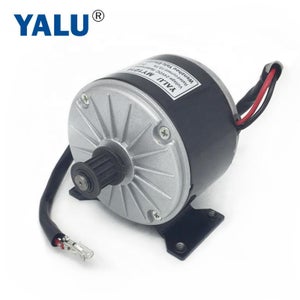

-Motor : 250W MY1016 with a 1/8 inch sprocket and 10 teeth.
-Wheel sprocket and chain : 1/8 inch chain and sprocket with 68 teeth.

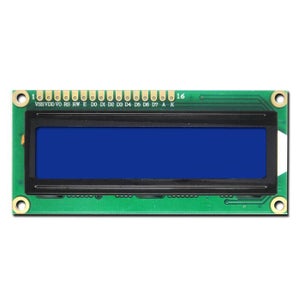

Step 2: The Screen
For the screen, you will need to print the two files below.
On the screen, you will see your speed, your battery level, and the current which is drawn by the motor. The potentiometer next to the screen is used to control how much electric assistance you need.
You 'll need 9 wires to wire the screen and the potentiometer.
Then, wire the screen as explained in this site. You'll need to wire the potentiometer as well, simply use the +5V and the ground from the screen, and the ninth wire to transmit the signal.
For the lid, glue a transparent piece of plastic, screw the potentiometer, and close the box with 4 screws. Water proof the wires coming out of the box with hot glue.

Step 5: The Motor Structure
This part will be the longest to build.
I won't explain in details how to build it because it strongly depends on the tools you have.
You have the 3D file of the total of the assembly so you'll be able to study it.
There are 4 major parts : the motor support platform, consisting of 4 steel tubes held together with plastic brackets, and an aluminium plate to hold the motor. Then, the arms and the connection linking the bike frame to the motor platform, consisting of 2 steel tubes, plastic parts, threaded rods, aluminium plates to reinforce. The anti-tilt bar, whose length can be adjusted, allows the motor platform to not turn around the axis the support are screwed onto. Finally, the chain goes through a small plastic guide (visible on the last picture), in order it not to jump out of the gear (you can choose not to use it, but then the tension will have to be much higher and the mechanical losses will be much higher).
Finally, you can build a polycarbonate casing for the motor, to protect it from water. The motor is supposed to be already water proof it's better to protect it a second time.

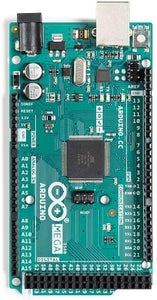

Step 6: Electronics
For this part, it depends on the box and the components you have. The wiring and the PinOut is detailed in the program, so it shouldn't be very difficult to wire. This is simple : the battery goes into the DC DC converter, on the motor driver, and on the 1:5 voltage divider bridge. The DC DC converter has to be set to 6.5V out, and it must go into the Vin port of the arduino. Then use the arduino 5V to power anything else with 5V. The current sensor must be put on the wires going to the motor, make sure you plug it in the right way. If you have any problem with that, ask in the comments and I will be happy to help!
PS : on the picture the wiring is quite messy, I improved it afterwards, but try to do a better job than me.
Step 7: The Arduino Program
The program is attached below. Of course it can be improved, this is just a program to run it with no problems. If any of you makes another program, feel free to share to share it!
The basis of this program is to detect when the pedals are turning, and if they do, the system will send the amount of current, which is chosen by the user between 0 and 25 Amps, to the motor. This requires a system control loop, I will not get in the details here but the parameters in the program seem to work just fine.
